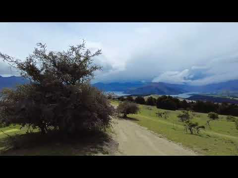

YouTube's been very slow to process the HD for my videos, but finally I have some interesting results.
I recorded 3 tests, on different days (3,4,5 of November).  Each was a jog along the same loop, at the same time of day (around 2pm), with the same weather conditions (sunny).  The route starts in the open but after a few minutes goes into the forest.  A month previously I had recorded a jog along this route (using Wide), and the picture ended up slanting, and getting really pixelated and jumpy in the forest.  My goal with these 3 tests was to see how using different types of stabilisation can affect the picture quality (compression artifacts) during the "challenging" bits in the forest.
Here are videos of the 3 tests.  Each contains my detailed GoPro settings in the description.  NOTE: My TMPGEnc trial ran out, so all of these use Premiere Pro's H.264 CBR 200 Mbps encoding.
Test 1 - Max Lens Mod - https://www.youtube.com/watch?v=Ml22WOyYdW8
Since the Hero 10 doesn't support the Max Lens Mod, I recorded this with the Hero 9.  I tried to make it look "crisper"  by using Medium sharpness (instead of Low), but I don't think that looks very good; next time I'll try Low.  The Max Lens Mod did a good job of keeping the image from tilting (as it had on a previous job through this loop), but once we get in the forest (around 8 minutes), we start getting lots of blotchiness, and then the picture starts jumping all over the place.   I'm guessing the digital stabilisation was having a hard time keeping track of things.  It looks gross.
Test 2 - Linear + HL - https://www.youtube.com/watch?v=vVqvIiz1Ymk
This and the next test are very similar; both use the Hero 10 in 4K 60fps, with Low sharpness and Natural color.  I think the overall picture quality looks better than the first test, but again, once we hit the forest, we get blotchiness and the picture starts jumping around.  Again, I think the GoPro's stabilisation logic can't keep up with those dark details.
Test 3 - Wide + Gimbal - https://www.youtube.com/watch?v=2tKKMS-ye_E
This time I used a gimbal (Crane M2), and set the view back to Wide.  It seems a lot smoother than the other tests, and more pleasant (for me) to watch.  When we hit the forest, there is still some blotchiness, but this time, the picture doesn't jump around!  So, the gimbal helps keep the camera still enough for the digital stabilisation to not go crazy.  Interesting!

I know it's been a while, but I've finally been able to focus on this topic again.
In the past year, I've recorded lots of trail jogs, with the Hero 9, 10, 11 and the DJI Pocket 2. I've also spent a lot of time watching other people's jogging and walking videos on similar trails.
Things I've noticed:
1) The dark bushes are almost always blurry.
2) Smoother parts of the trail (where there are fewer rocks) tend to get blurry. There is one section on Mount Iron, for example, where I see the same blurriness in multiple videos taken last year and this year.
3) CBR 300 is *slightly* better than CBR 100. The blurriness is still there, but the patches of blurriness are smaller. The CBR 300 files are about 3 times as big.
4) TMPGEnc CBR 100 is slightly better than normal CBR 100, and same for CBR 300. The TMPGEnc files are the same size, or even a little smaller.
5) TMPGEnc CBR 100 often looks better than normal CBR 300.
6) I haven't noticed any more gaps in the audio with TMPGEnc, so maybe that had to do with pausing.
Here are some example videos. For each video, I recommend you
https://www.youtube.com/watch?v=VRnUjZjjWd0 - CBR 100
https://www.youtube.com/watch?v=ETAhfhtPqPg - CBR 300
https://www.youtube.com/watch?v=wsritcNej30 - TMPGEnc CBR 100
https://www.youtube.com/watch?v=KDOvKL0cAig - TMPGEnc CBR 300
A good place to compare these is at 24:23, which I can reach by pausing the video and then hitting "7" on my keyboard. I presume this means it is 70% of the way through the video. Here you see lots of blurring. The TMPGEnc CBR 300 manages to get the most detail in the distance leaves. The bush on the left is a dark blurry mess regardless of encoding.
Another good pause point is "9" (90% of the way through, or 21:56). Here you can compare blurriness in the trail, the leaves on the various bushes, and even on some of the trees and houses on the distance mountain.
To my eyes, I would rank the quality like this:
1) TMPGEnc CBR 300 - best
2) TMPGEnc CBR 100
3) CBR 300
4) CBR 100 - worst
Is that what you're seeing as well?
So, the TMPGEnc encoding is looking promising.
What settings should I use for TMPGEnc encoding? I think I just selected "High" and left everything else at the default.
Are there some further tweaks I should do?
Also, are there any other exporting settings I should try before purchasing TMPGEnc?
Thanks!

Community Beginner ,
Dec 14, 2022 Dec 14, 2022
Copy link to clipboard
Copied
Hi, I went ahead and bought TMPGEnc.
I recorded another video a couple days ago, with the GoPro Hero 11.  I was recording with high bit rate, 4K@60, ISO 100-400, white balance 5500K.  Sharpness was set to low.
What I found is that the original video started off looking pretty good:
https://tripalot.com/issues/img/20221213-hero11-ok.png
However, by the end of the video, the greens were all sort of smearing together, like this:
http://tripalot.com/issues/img/20221213-hero11-blur.png
I was moving *faster* in the first frame, so it seems odd that it looks so much better than the later frame (recorded about 45 minutes later, when I was standing still).
Could the blur be due to the decreased lighting?  Or maybe the GoPro just got "tired"?  I just don't understand why it ended up looking so blurry.
Again, these frames are from the original video, before any editing (so it has nothing to do with Premiere Pro and TMPGEnc).
So, first I want to improve the quality of my source videos, and then I'll tackle Premiere Pro / TMPGEnc.
Thanks for your help!
Dec 18, 2022 Dec 18, 2022
Copied
Clearly, the second screen shot looks blurry, especially in the green patches.  But even the first one looks a little smeary.
Is this because I'm recording at 60Hz instead of 30Hz, so I'm giving the camera half as much time to capture data?  (I read this somewhere yesterday).  If so, then why do other peoples' 4K @ 60Hz GoPro videos look so crisp?  Especially Prowalk Tours - he's been using GoPro cameras for years and I never noticed this sort of smearing, except in his very earliest videos (like his first Naples one).
When you see smearing like this (and no, the lens was not dirty), what is your first reaction in terms of things to fix?  Are you thinking about increasing light, decreasing motion (although there was none in the second image), tweaking ProTune settings, or perhaps disabling some of the image stabilisation?
