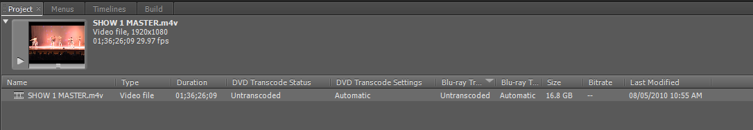

Please post a screenshot of your En project panel, including the column headers.
-Jeff
New Here ,
Aug 10, 2010 Aug 10, 2010
This is one of the M4V files in a new project. Notice it says "Untranscoded" instead of "Do Not Transcode".
