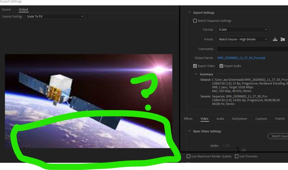

Some one know why i can't hae the preview export window in the export media window?wa;d.jpg
