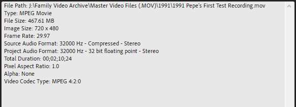

Here are the properties tab of the original .MOV file I'm working on.
As far as I can tell, the sequence properties match the clip properties.
When I imported the clip I allowed Premiere to match the sequence settings to the clip

No not Windows, but Properties as shown in Premiere.

Sorry about that, here you go.
