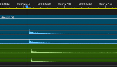

We've all had the experience where Premiere couldn't auto-sync audio and video, and so we switch the timeline to Audio Time Units and get to nudging. (I've also recently learned that you can use a multi-camera source sequence to auto-sync and merge audio and video). That is only where my problem begins.
Once the video and audio are "linked" together, either through merging it myself or via multicam or nesting, THE AUDIO IS NO LONGER ALIGNED! This is after Premiere supposedly aligns the audio by its exact waveform, or I do it manually by eye.
I've tried switching the timeline back to frame count after aligning via ATUs, trimming the video and audio,  and then merging, and it still happens.
Here's an example of auto-synced multi-cam on my timeline. This is a clap, and the de-sync creates a very audible clap-clap.

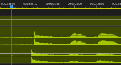

Here's an example of a manually synced & merged clip, placed back into the timeline: 
Again, the clap very distinctly sounds like a clap and a half because of the de-sync.

The way Audio Time Units work in Premiere Pro can be a bit unintuitive. When you nudge an audio clip using Audio Time Units (ATUs), its position is maintained with sample-level precision—but only until the clip is moved or edited as part of a video selection. Once that happens, even using Edit > Undo won’t restore its previous ATU-aligned position.
This behavior is one of several reasons why merged clips are not recommended. They can often introduce sync inconsistencies, especially when precision is critical.
For a more reliable workflow, I recommend the following:
  • Manually sync your audio and video within a Multi-Camera Source Sequence, using Audio Time Units.
  • Do not adjust the synced clips after this point.
  • Once you've locked in sync, add a sequence marker at that sync point within the multi-camera source sequence using Audio Time Units. This will give you a reference that retains its exact position even when you return to frame-based editing.
