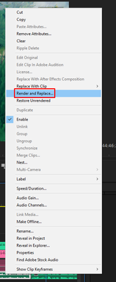

Oct 24, 2019 Oct 24, 2019
In case anyone wonders in here, I FOUND A FIX. Right-click your audio clip that has no waveform, and click the option that says "Render and Replace." It will spit out the new clip with the audio waveforms in full view. Hope this helps.

Jan 12, 2020 Jan 12, 2020
Just easily Right click on you audio track then Render and Replace.

Jan 29, 2021 Jan 29, 2021
Try right clicking on the clip on the timeline > Render and Replace. Worked for me.

Feb 20, 2021 Feb 20, 2021
What worked for me is:
1. Unlinking Video and Audio
2. Right-clicking on the audio "line"
3. Render and Replace...
