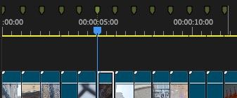

Hi,  is this a bug? When I try to add clips to match the Markers, using "Automate to Sequence", a 1 frame gap is left between the clips. I have to manually extend the duration to get rid of the gap.
What's the issue? How to solve it? Is it a bug? I tried looking online but there were no solutions. I've tried matching the frame rate, installing the new Premiere Pro, trying to do it as a new project out, but all the same. Still the 1 frame gap for certain clips (not all, weirdly). And no, it's not because the clips are shorter than the marker duration (I could still extend it).

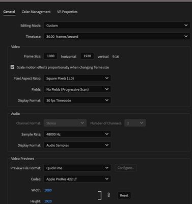

  • Issue - When adding clips from a bin to the timeline, via "Automate to Sequence" to match the 'markers', there's a gap / blank space of 1 frame. Image below.Screenshot 2025-05-14 at 12.05.31 AM.jpg
  • Steps to reproduce - A numbered list of the exactsteps needed to reproduce the issue.
    1. Select a bunch of clips from a bin
    2. Go to Clip > Automate to Sequence
    3. Click OK after the below, especially for Placement is "At Unnumbered Markers"
    4. The clips would then be placed into the timeline.
  • Expected result - Clips should be placed to match the "Markers" without any blanks in between clips (unless if the clip is shorter than the marker duration).

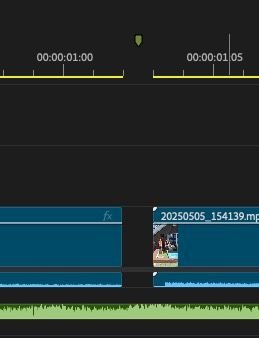

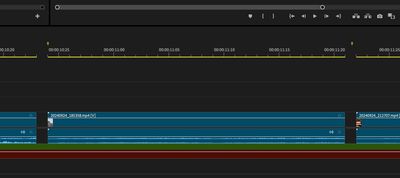

  • Actual result -  Clips are placed to match the Markers, but there is a blank of 1 frame. (see below, there is a tiny gap on the yellow line)Screenshot 2025-05-14 at 12.14.18 AM.jpg

  • Video format - NA, not related to exporting or playback.Screenshot 2025-05-14 at 12.05.56 AM.jpg
