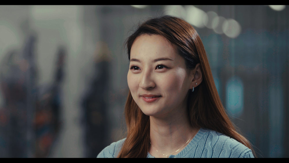

In the past month or two I've noticed Premiere has started introducing a lot of banding into my footage that was not there before. It didn't used to happen before so I think it might have started in the latest update.
I am importing footage from multiple cameras, but all in various flavors of 10-bit ProRes (LT, 422, HQ), and in log. And as soon as it is imported to Premiere, there is banding in it. Yet, when I open the same files in Davinci Resolve or elsewhere, there is no banding.
Because the footage is in log, the banding isn't visible until it has been transformed and contrast added, but once there is contrast, the banding is quite prominent.
I always export out my edits 16-bit ProRes 4444 ungraded for color grading in Resolve, and now I have started getting heavy banding. I will attach a sample still, see left and right of subject, in out-of-focus areas. I will attach one still exported out of premiere, and one exported out of resolve to show the difference.

I have had Max Bit Depth set in my sequence settings, and in my export settings, and I use 16-bpc and MBD set. I have also tried exporting a still .dpx straight from the program monitor Export Frame option, and it does the same thing.
The banding appears in all the log files I've used, REDwidegamutRGB/Log3G10; Canon Cinema Gamut, Canon Log 2; Rec.2020/Canon Log 3, Arri WG/Log C3.
I think the problem is definitely happening before the export, as I can see the banding appear in the sequence when I use Lumetri Color to temporarily grade my clips (which I remove completely before export). The export just includes the banding.

I do everything for Rec.709 delivery. I have one BenQ monitor fed from an Ultrastudio 3G as well as a 10-bit GUI monitor. And the banding is definitely in the file, not the monitor as you can see from the stills I had attached.
