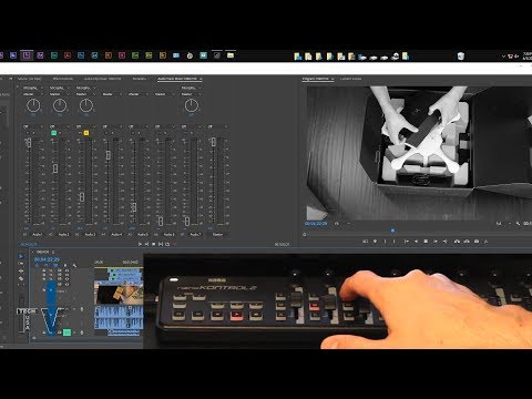

I have always expected Premire Pro and Audition to kind of work 100% correct with most control surfaces.
This video demonstrates how to connect the Korg nanokontrol 2 to any audio software program. Korg NanoKontrol 2 https://amzn.to/3gLSlqe Adobe CC 1 year https://amzn.to/3Da0qMN Links are monetized
