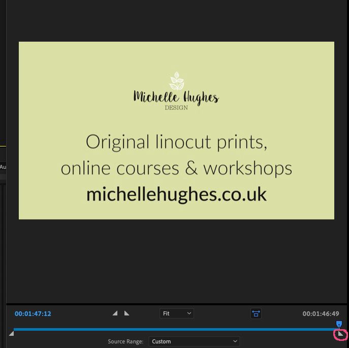

Eurika! This has been drivig me mad. I was a bit overwhlemed with eveyones solutions as I've been teaching myself over the past year to make online courses.
I've just solved it for me and it's so SIMPLE.
When I set my in and out to exatly the length of my sequence it adds one black frame at the end of my export.
Instead I've dragged my last image/clip to be longer.
When I exported I have been seeting it set to 'sequnec in and out' .
Instead I dragged the triangle to reset the out to the point when there wasn't a black end screen.
Problem solved at last!
Hope that helps somone. 🙂

Hi Michelle and Community,
Try Source Range > Entire Sequence. Michelle, you had it set to Custom and Sequence In/Out.

Community Beginner ,
Jul 18, 2022 Jul 18, 2022
Thank you. That's what I had been doing. I was trying it that way to see if it worked instead. Neither made a difference.
