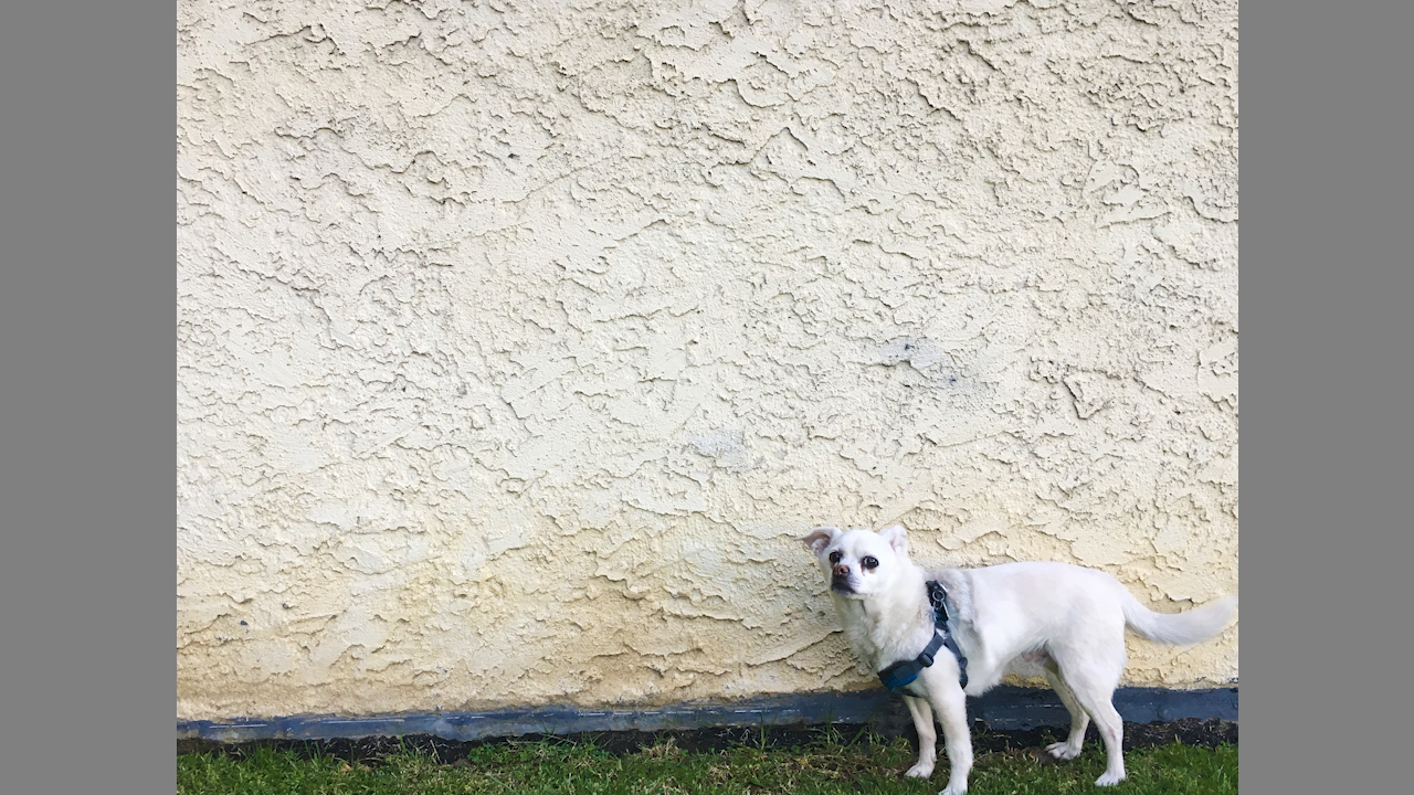

Have you considered matching what's done professionally for picture that doesn't fill the frame?  You'll notice in documentaries and news broadcasting that the picture is scaled to fit the width or the height of the frame and then the resulting pillars or letter boxing is filled with the image scaled up and blurred (behind the picture being shown).
It would then look like this:
(The dog in the photo is Buddy.)
-Warren

Just a suggestion on the Buddy clip:
I would move the "pillars" so that all three "blue lines" are line up with each other.
Then again, it's a matter of personal preference.
Jan 22, 2019 Jan 22, 2019
I agree.  At the same time, when it's the 9,745th time you've done it and if it's video it's going to be constantly changing, I've gotten in the habit (for better or worse) of just setting it and forgetting it.
