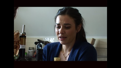

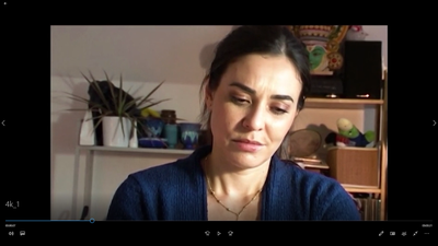

Hi FlyingForFun. Thanks for the detailed answer. Yes, the video is an interlaced one and it has the horizontal blinds effect. Post here below a frame.

Okay lots of answers in that list;  Your source footage is in fact interlaced, in the screen shot you provided you will see it say "lower field first", that's a type of interlacing.  I would suggest you apply a de-interlace (or consider it);  Apply this effect BEFORE others.   Chance your sequence settings so its not a interlaced sequence also, or you will not be able to de-interlace it;  This step will be very important to remove some of the 'blur' especialy in places where there is movement on the frame (technicaly the 'blur' from interlacing is called combing btw).
the 115% zoom is not a big concern but with this source footage its likly contributing to your blur also.  When you start video of your original source quality, it will magnify flaws.  I would suggest if you can in your settings,  try and change the transform setting for zoom to BiCubic and see how it works for you, its often better results, but not always.

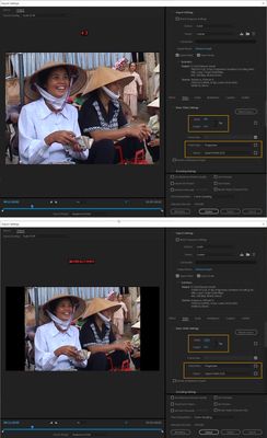

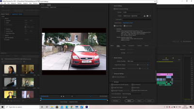

Post screenshot export settings with left tab to output with an image.
Jan 21, 2021 Jan 21, 2021
This is how you export your video either 4;3 or widescreen.
Scale footage as little as possible in the timeline.

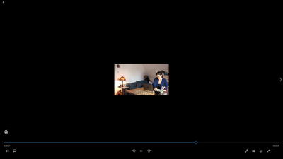

FlyforFun I still don`t understand the Upscale thing that you said. I followed your instructions and the result is that the image is very small like this.
Did I miss anything?
Enthusiast ,
Jan 22, 2021 Jan 22, 2021
Ok, so your on the right track with that smaller picture inside the bigger video frame.  I assume that sample is from the output you created in Handbrake, thats deinterlaced?  if so, continue to use that.  Also,  I assume the timeline you created is 4k based on how small that picture is inside the timeline.

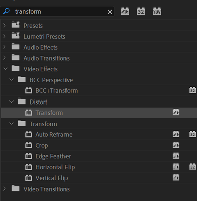

To get that picture bigger in the frame using the built in tools of premier,  apply the "transform" effect, the one that appears under the title of "distort" in premier.
The one highlited here in this pitcure:

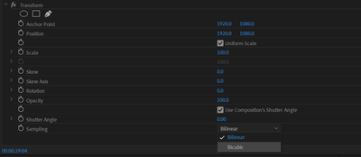

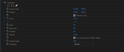

Once you do that, edit the effect thats been applied to the clip, and you will see a window that looks like there.  There is two things you need to change.    Change the scale number, which should read as 100% to a bigger number, until it fills the entire video frame.  It probably a number around 400%, but you may have try a few different ones.  The varible is the "samples", I would change it to "bicubic", it defaults to "bilinear".
These changes will  leverage premiers built in scale up, and will give you good results.
When you do this, and export, the output should be better.

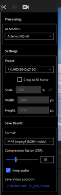

As for Topaz.  if you wan to try that,  take the footage you deinterlaced from Handbrake, and import it into Topaz,
In Topaz, there is a bunch of settings for the type of scalign it does,  for now, leave it at the default one.  In the middle of the right hand screen, you will see this dialog:
In the "settings" dislog, select the output size you want.  For your workflow, go ahead and pick 4K, leave the check box for Crop to fill frame off if you want,  you and click it and the live preview will show it what it does.
In the "Save Result" pick MP4, like the screen shoot, Check off keep Audio, pick your file save location.  Pick a compression factor.  I always use 5, which makes really big files, so I suggest you try 10 which will be smaller and work just fine.
On the top right of that screen shot you will see an icon with an 'eye' inside a camera, you can click on that to preview a few seconds of your settings applied to the footage you imported.    If you dont like the result, try different "AI Models" and see which is best for your footage.

Ok, I`ve tried. The result is not so bad. You can see by yourself
Anyway, thanks a lot for the detailed instruction , it really helped

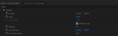

As a pro tip, I would never use the scale, position that's the default for clips (See screen shot below)
The transform effect you just used is the preferred way.   The only time I use the default (above) motion / position / is to set it once, and never move it.  But if I have to scale, I ALWAYS use the Distort/Transform.  if you stick to this approach, it will serve you well into the future as it supports motion blur etc and much more versatile.  Frankly, I have no idea why Adobe keeps that default position/scale around, it should be replaced with the Distort/Transform.
