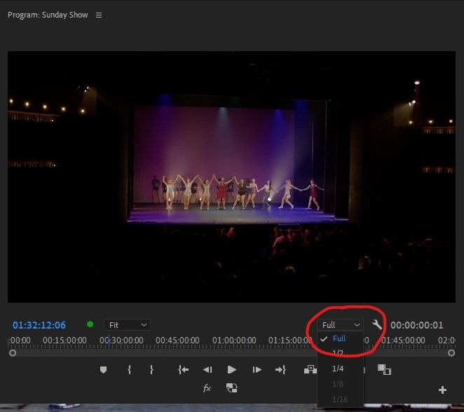

Is your playback resolution set to full?
That might fix the playback issue.
If you could post a screenshot of your export settings that might tell us more aout the export softness.
