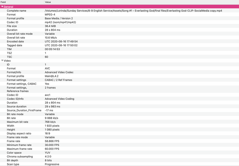

Post computer specs. Screenshots media properties (Mediainfo in treeview) and export settings.

Yes, the hard cuts, but I guess I mean the switch from one to the other. I didn't add any transitions added like cross dissolve. I attached the stuff you asked for (hopefully everything). I also added a screenshot of my timeline as well of the sample clip I provided (0:28 second video sample).

your source clip has a variable frame rate which premiere has intermittent problems with.
The following FAQ is about screen recording clips, but video recorded on most smartphones has the same issue
https://community.adobe.com/t5/premiere-pro/faq-issues-with-screen-recorded-footage-in-premiere-pro/...
Use Handbrake to convert to a constant frame rate

I thought as much. Your clips are variable framerate.
Although Premiere supports vfr, in real life it does not work all that great.
Need to fix that first and then you can replace the footage in the Project window with the new clips.
