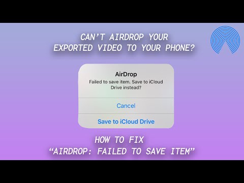

I'm exported a video from Premier Pro 19 as an mp4 file. When I try to Air Drop the mp4 to my iPhone, I get this message on my phone: "Failed to save item. Save to iCloud Drive Instead?" Why wouldn't I be able to AirDrop this to my photos in a normal manner? Is anyone able to airdrop their Premier Pro exported projects to their iOS device?

https://www.youtube.com/watch?v=E7g2t2WIUFg
this should help - it helped me!

I had the same problem and now I already fix it
I follow her instruction
