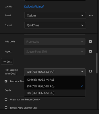

I'm trying to export video for use on Shutterstock. I have done so using H.264 with no problem but when I try ProRes it will not work on SS.  When uploaded and I select view a larger preview, I get a message: "No video with supported format and MIME type found" and it will not play.  SS support is telling me to turn of HDR - which I did not think was on, since I have not checked the box shown below - yet it seems like it picks one of the three options anyway.  I don't know if this is really the issue at all, maybe support is mistaken.
Below are the settings showing in the export screen.

Which ProRes preset did you start with? Avoid those with HLG or PQ in the preset name, as those are HDR.

Thanks for replying. I did't use a preset to start with.  I used custom and picked the settings that I thought were right.  I haven't treid to export in anything but H.265 before - kinda dumb to this....:)

Start your Export with a QuickTime preset selecting ProRes 422. As long as the framesize/rate match your sequence (they wiill) don't change anything but the name/location of the export.
