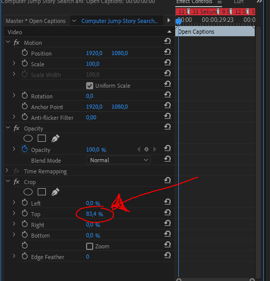

Aug 11, 2019 Aug 11, 2019
I found this comment on another site - and it saved my life and hopefull others as well.
"If you add a crop effect onto the subtitles, you can then crop the top of the box so the text looks centered in the background box. This is the best way I found to get around this until they fix it."
I am now able to go to sleep to night! haha
