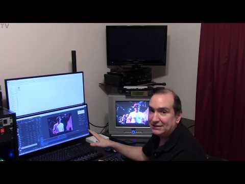

If the video files are interlaced I would put them in a 60P timleline if the final destination is social media. If the destination is DVD or Blu-ray just use an interlaced timeline. I use a Firewire based DV converter myself. You can see the results near the end of the video. Perhaps your method will produce better results.
https://www.youtube.com/watch?v=dVLUxRkPMdA
I use the Canopus ADVC 110 firewire DV converter and the Intensity Shuttle. Both products are discontinued. You must by them used. Adobe CC 1 year https://amzn.to/3Da0qMN ADVC 110 Power adapter https://amzn.to/3DxSfvb Firewire 400 to 800 adapter https://amzn.to/3sxGVJ9 Firewire cable 6 pin to 6 ...

How would a Firewire DV converter help you out? Did you watch my video?
You connect the audio and video cables form the Hi-8 camera to the DV converter. You then connect the Firewire cable from the DV converter to the PC. It is that simple. The video files will be in the DV-25 codec. Interlaced is what you want. Leave it as interlaced video in a 1080i sequence if you want to create a Blu-ray disk. If you want to post on social media you can use a 1080P sequence at 60 FPS. It is that simple. The video below might be worth watching. I don't recommend using cheap USB video capture cards for a reason. You can buy the Firewie DV converters used on ebay. It will be the easiest method when using Premiere Pro, FCPX and iMovie.
On a side note Warren recomended using a Digital-8 camera for pass through. You can use most Firewire based cameras that way. It will have the exact same result as using a Firewire DV converter. I don't recommend the Blackmagic Products because the ones I tested needed a TBC. Warren stated the Blackmagic Desing Intensity Pro 4K can capture old VHS tapes without a TBC. I would asks the folks at Blackmagic Desing if that is correct before buying it. Having said that some camcorders and VCRs have a TBC built in. Yours might. If it does the Blackmagic Products will work. You can buy a used Intenisty Shuttle on ebay for pretty cheap.
https://www.youtube.com/watch?v=UsDTDkaqmpI

Warren, please watch my video. If after watching my video you come to the conclusion you have a method that is easier, yields better results and interacts with Premiere Pro better than my method then please post a few samples of your results as well as a tutorial.
Warren, you just posted.
"If it was 1998, a FireWire DV converter would be top choice for 8mm and Hi8 analog video to digital video conversion".
In another post your wrote.
" If you happen to have access to a Digital8 camcorder with DV pass-through, that's probably your best bet for recapturing the tapes via Premiere Pro's DV capture; however you'll need to have FireWire or Thunderbolt with the right adapters to FireWire".
Just so you know using a Firewire camcorder in pass-through mode will yield the same result as using a DV converter. I mention this in most of my videos but sometime I forget. That being said your method is for exporting at 480P. Who exports at 480P in the year 2022? Keep in mind I did not follow your instructions at all but I have no interlacing artifacts and decent image quality. How can you explain that considering you stated everyting must be done as you described? Keep in mind I am not saying my method is the best. Simply place your VHS tapes in a 1080P sequence and zoom in 80%. Let us see the results and let people judge for themselves if your method is better. Perhaps it is. I am always looking to learn new things but I cannot just take your word for it nor should anyone else.
You claim I am using my Intensity Shuttle incorrectly. The staff at Blackmagic Design has stated their product require a TBC. How can you explain that Warren? Please tell me what I am doing wrong. Or even better. I want you to capture Hi-8 tapes from a Hi-8 camera using your Intensity Pro 4K. I want you to capture the video with the TBC enabled and then capture the video with the TBC disabled and let us see the results. I bet your video will yield the same results as my video. Having said that I will admit it is possible the Intensity Pro 4K is the only product from Blackmagic Design that does not need a TBC but I cannot take your word for it nor should anyone else. If you can demonstrate the Intensity Pro 4K works without a TBC (it might but I need proof) I will suggest the Intensity Pro 4K instead of the Firewire based DV converters from 1998. As a professional video editor you should be able to create the video in 20 minutes. Why not educate us all?  As I stated I am always willing to learn but I cannot take your word for it. I need proof as should everyone else.
