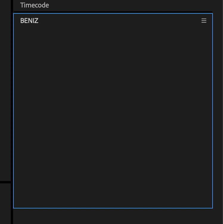

Hey,
I've a problem with Premiere 2025 that all of my extensions is like unvisible,
I mean, I can open them, I can guess where to click (and everything works) but the GUI isn't loading.
Thank you
Community Beginner ,
Oct 30, 2024 Oct 30, 2024
I wrote a caption for the photos but it didn't add it but: My extensions seem to work, I can click button based on my memory but the UI isn't loading
Even this one is unvisible
