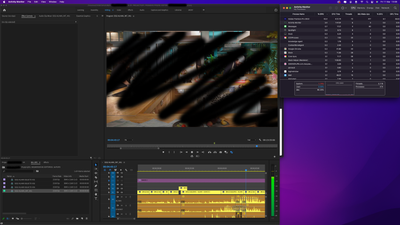

Just as an update - I've been using screen recording software non stop, but it never seems to crash whilst its running but as soon as I forget to record it cuts out of course... This is my setup with the activity monitor which I keep constantly running next to it - it never seems to fluctuate much. Crashed twice today without doing anything taxing, just selected a clip on the timeline and that was it.
