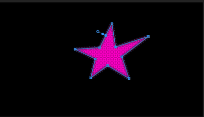

As an example, I have a pink pattern layer with a static, star shaped mask.
This layer is then nested, and the nested sequence has a position/rotation/scale animation applied, as if there were a camera zooming into the pink layer.
Is there any way to create a new animated mask for an unmoving green pattern layer that perfectly matches the shape of the original mask? The below gif is an imperfect recreation of what I'm going for.
