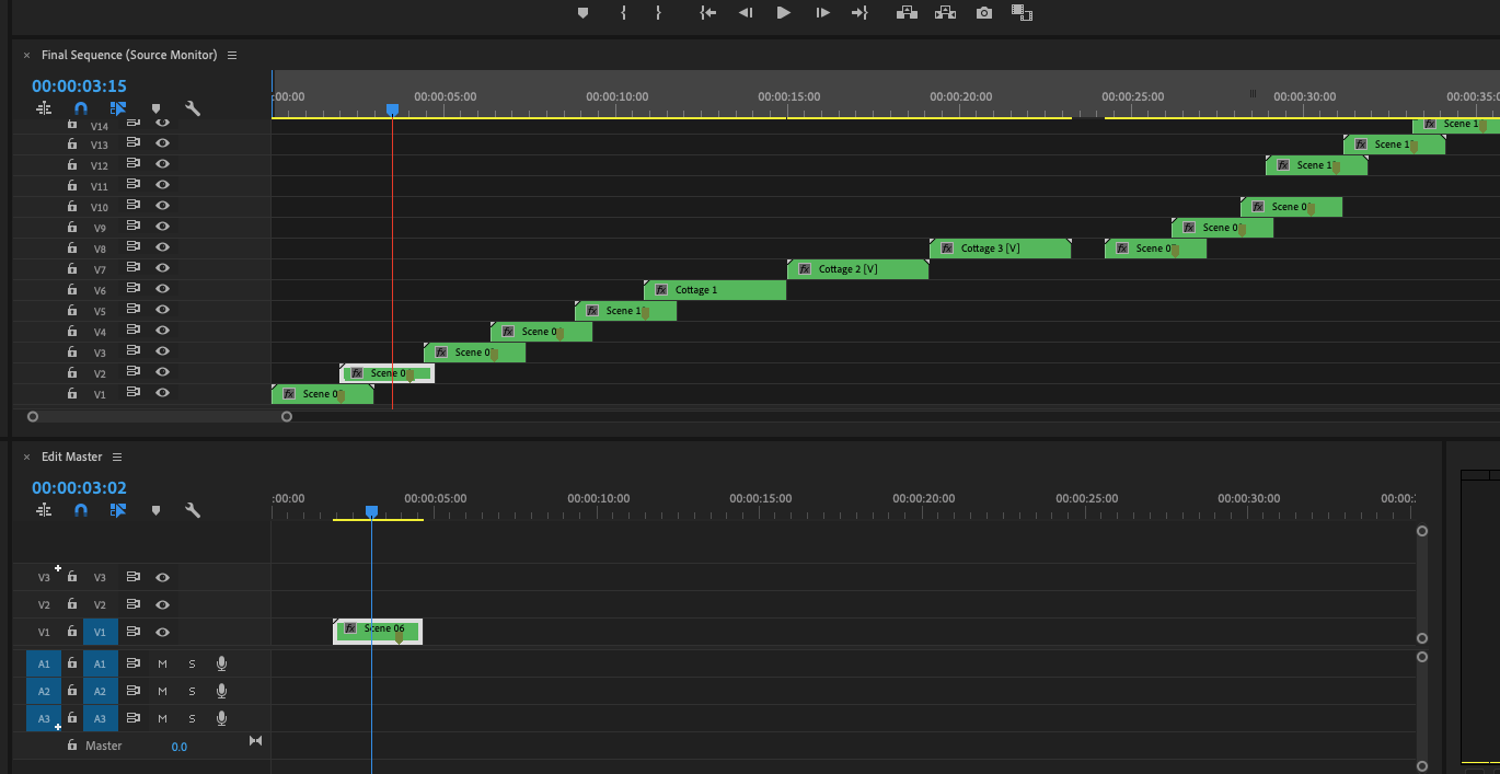

did you try to use a 'Pancake' timeline?
start a new sequence and drag the old one's timeline just below the new sequence timeline,
you will have 2 timelines above each other. Simply drag the content you want from one timeline to the other,
this will create new sources for whatever you drag, and you can edit them separately without affecting the originals.
you can even do that from one project to another since you can have more than one project open since premiere pro cc 2018.

Ok never hear of 'Pancake' timeline'. Just watched a quick YouTube guide and it seems an option for sure, thank you for the suggestion.
I do have PP templates and often wish to use selected sequences from then to create 'new' versions with sequences from various templates...this to create unique options for me.
I guess 'Pancake' timelines' would mean copying sections from one timeline, onto a new one would be something I should consider trying?
Thanks again for your suggestion

Okay, the tutorial you shared shows you how to use 'Pancake Timelines' in a way that
allows you to make edits to your sequence (that shows on the program monitor)
by editing the sequence that you dragged to the source monitor.
When customizing templates the way you want, forget about that because you do not want
the changes to one sequence affecting the other. So, what you have to do, since you can
now open 2 projects in premiere pro, is to open the template, then open a new project where
you will have the final sequence. Stack the template's timeline under or above your new project's
timeline as pancake timelines, and start dragging from the template sequence to your new sequence.
This way you will have new copies to your new project sequence. Whatever you do with those
will not affect the template ones.

MyerPj since you have the option to open more than 1 project on Premiere Pro, why neglect that and go for complicated file naming stuff. Let's make life easier and just open the premiere pro template as a project, then start a new project which should be the customization project. Stack those 2 timelines above each other, drag the sequences and pieces you would like to customize and simply drop them to the customization timeline. This will create duplicates of all what is dragged with all their assets and attributes as well.
Stating that you are not gaining anything from a 'Pancake' workflow comes from poor knowledge around that. Essential Graphics? you can simply drag and drop those as well in a couple of seconds and customize them. I didn't get your idea clearly.

khomthepreditor​ did you watch the video tutorial i prepared?
even with nested sequences, just a 1 second process of dragging and dropping
from one project's sequence to another will create the desired duplicates, and
when those are customized, the original ones of the template will remain intact.
using stacked timelines related to different projects creates a really wonderful workflow,
you can either drag and drop everything, you can drag and drop graphics, you can
drag and drop clips, nested sequences, all of the sequence, drag whatever you like.
its just the same procedure as importing sequences from another project or replacing bins
or whatever other mentioned procedure, but in a simpler and faster way!!! Since Premiere Pro 2018
we have the option of opening 2 or more projects, why not take advantage of that?
Watch the short video I prepared to get the idea please ...

Hey, I just got around to watching it. I was misunderstanding what you were saying. I thought you were pancaking timelines/sequences from the same project, but I now see how working in different projects allows you to make that copy super quick and easy! I've officially learned something today, so thank you for that
Also just editing this comment real quick to note that you said...
The pancake workflow works but you have to save as many projects as you want duplicated sequences...
Which was actually another thing I was going to add. It could be a pain to basically have one sequence per project, but then again since we can have multiple projects open simultaneously, it really shouldn't be an issue!
Apr 01, 2019 Apr 01, 2019
yeah I can confirm that this sentence I stated 'The pancake workflow works but you have to save as many projects as you want duplicated sequences...'  is actually WRONG, you don't have to do that since you can drag from one project
sequence timeline to the project panel of another project and do this as many times as you like, creating as many duplicates
of the same sequence that you can edit independently without affecting the other duplicates. So you do not have to make
as many copies of the same project, the statement was out of so many replies and getting a bit lost in that, this happens
sometimes, but it was corrected in later posts ... so please follow my latest advises concerning pancake workflows... Thanks!

When you make multiple duplicates of a sequence by dragging it to the project panel of another project, does it create unique duplicates of the assets within that sequence for each copy you make? I'm wondering if you have a sequence in Project A that contains a title, you can drag that to Project B three times to make three unique sequences in Project B identical to the sequence in Project A, but do the titles in each of those three unique sequences point to the same title in the bin?
I may just end up poking around with this more myself, since the whole concept of copying sequences this way is totally new to me (having only used Project Manager in the past). Thanks again for teaching me something I didn't know that I didn't know
Apr 02, 2019 Apr 02, 2019
Yeah this will create unique duplicates with their own unique assets, but, if you have nested sequences inside,
you have to drag those from the timeline to the project panel to create duplicates of them, because let's say
you have a nested text inside sequence 01, dragging sequence 01 to the project panel 3 times will create
3 duplicates of the sequence with all its assets, but the nested text inside will always point to the same source,
which is why you need to drag the nested text sequence 3 times as well to create 3 unique duplicates.
This applies to all nested sequences and not just nested text.
of course there willbe lots of people asking why you don't duplicate them from straight from the project panel,
you can, but doingso following this stacked timeline (pancake) workflow is easier for you to see everything clearly,
then drag and drop seamlessly in between projects, sequences and timelines...
You have to experiment, and let us know if you find better ways or something we do not know about,
we all learn from each other by the way, this is why such communities exist! Luckily ...

premiere pro templates are already structured for a fast drag and drop process,
no need to replace anything or replace bins or whatever. you just need to drag and drop
your own assets into nested sequences which are image or text placeholders usually.
As far as I understood, the user wants to extend the template's capabilities, to add more
of those nested sequences, graphics, etc... using the pancake workflow is best and fastest
for this kind of work if you already have premiere pro cc 2018 and later ...
Please again check the workflow I shared in the prepared video to understand more ...
I only worked with a nested text layer, but it works the same for image/video placeholders,
which are nested sequences b the way ...
