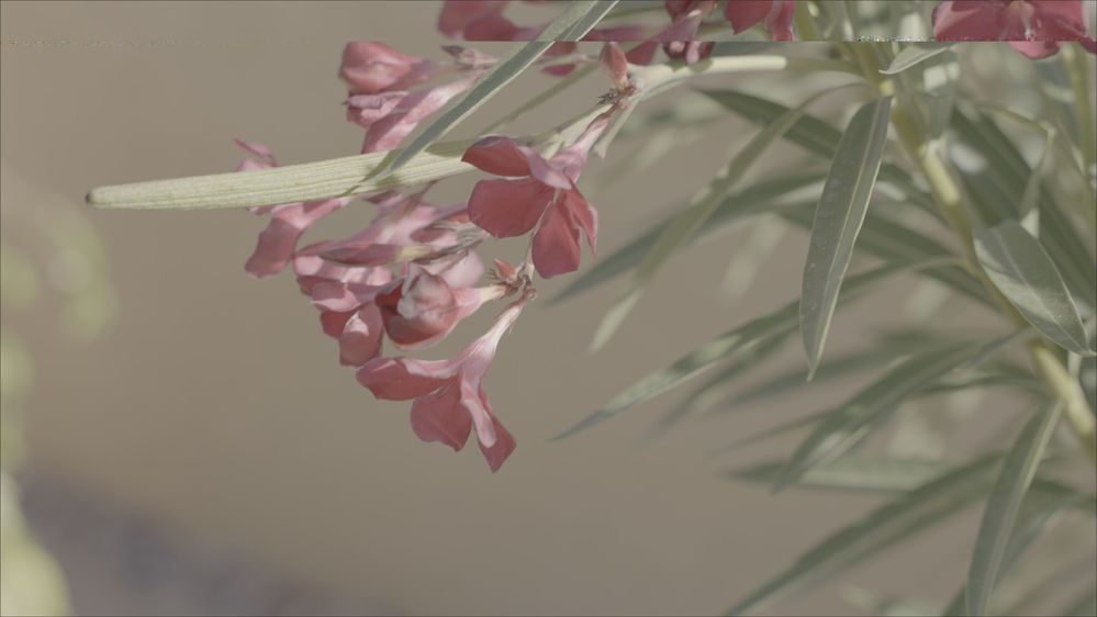

Update on this - it turns out that the files did, indeed, have corrupt frames but the VLC player was just skipping them.  So it appeared to be working in VLC player but the error was still there.
So the problem is not with the Adobe apps.  The problem was in the video files, themselves.

Sorry to hear about this. Please share a screenshot of the glitch that you are experiencing in Premiere Pro. Also, have you tried switching the Renderer to Mercury Playback Engine Software Only & checked if it's working properly?

Hi Sumeet - I have attached an example of a corrupt frame taken from Premiere Pro.  I have tried the different Mercury Engine settings and the corrupt frame appears in the same spot and looks the same as what I've attached here.

Well it looks like the attachment isn't showing.  Let me try this...
