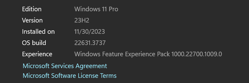

- I'm on Windows 11

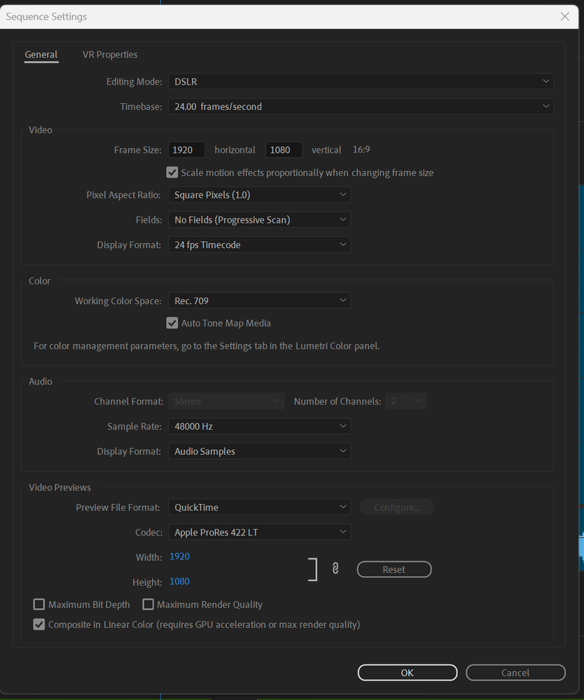

- I posted details of my current timeline in a screenshot. It's the same settings for all my projects
- For this highlight project I'm working on, all sequences within the project have the frozen timeline indicator
- I opened a few others projects that I worked on a few weeks ago, and got mixed results. Some projects will only have smooth playback with current indicator on smaller sequences, under 5 mins and little videos on the timeline. Another project has extremely laggy timeline indicator, but not completely frozen like I'm currently experiencing. Overall, this issue seems to affect a majority of the stuff I'm working on.
