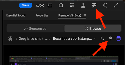

Adobe Employee ,
Aug 07, 2025 Aug 07, 2025
Hey @Stan Jones, thanks for letting me know. I'm searching for your feedback now. Did you use the Premiere feedback form, or the Frame.io panel specific feedback form? They route two different places, and I want to make sure I look in the right place.
