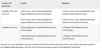

No, that is not the place for you as a user, to add or remove LUTs. That is inside the Premiere Pro program/package files LUT folder, which again is accessed by relative position in the folder NOT by name!
Premiere, Ae, and Me all are installed with the exact same contents in those folders, and by design (for some reason I don't understand) access items in those folders by relative position in the folder when applied via the Basic and Creative tab LUT options. And so applying LUTs, if you've added things in to those folders, gets messed up royally.
Add a LUT named "Davids Deep Reds" to the Pr/LUTs Creative folder.  Use it on a clip in a project. In prep for another project, add a LUT called "Antwerp Green" to the same folder. Apply that.
Now relaunch Premiere, and go back to the first project. "Davids Deep Reds" is no longer the LUT being applied, because it is now one LUT 'farther' down the list of alphanumeric sorting. This is not the behavior any of us wants. But it is so easy to avoid.
And across the tons of complaints I've seen about Pr and Me messing up in applying LUTs, it is nearly always because people have put LUTs in the Pr/LUTs folder. And not in the places the chart below shows.
The following chart shows the locations that users should be using. As noted, Pr will scan for these folders at launch and load into it's short-term memory anything found there. And they will apply the LUTs in these folders based on the name of the LUT, not by place in the sorted folder. So you can add and remove LUTs and as long as the needed LUT is there, it will still be applied correctly.
For some also unknown reason ... which I have complained about in emails, this forum, and in person at every live NAB and MAX since they started this system ... they don't create all the folders for the users to use in the proper 'tree' structure. No user gets a Technical or Creative LUT folder on installation ... you always have to create those before adding your LUTs into them.
But some users, mostly to the Mac side but not entirely, for some unknown reason, don't even get the LUTs folder added by installation of Pr. So they have to add in the LUTs folder, then the Technical & Creative, then drop their LUTs in those folders.
Well, silly yes, but still it takes a few seconds to fix one time. And then works forever. I did this several years ago, and have not needed to change anything since. I park my LUTs in the Users/username/Appdata/Roaming/Adobe/Common/LUTs folders. Just 'cause when I started with this, that seemed easiest.
Now, really, the Program Files/Adobe/Common/LUTs folder is easier to get to, and the one I typically recommend. Either works. I have icons on the desktop for quick access to those folders for adding or removing LUTs.
Just avoid the Premiere Pro folder like the plague. Or ... it will feel like it.
Really, to me a far bigger problem with their LUT application is that when you create and add a LUT to the app, you have to close Premiere and relaunch before you can use it. They don't have any "refresh" feature which most apps do. They should, and I've also complained about that.
