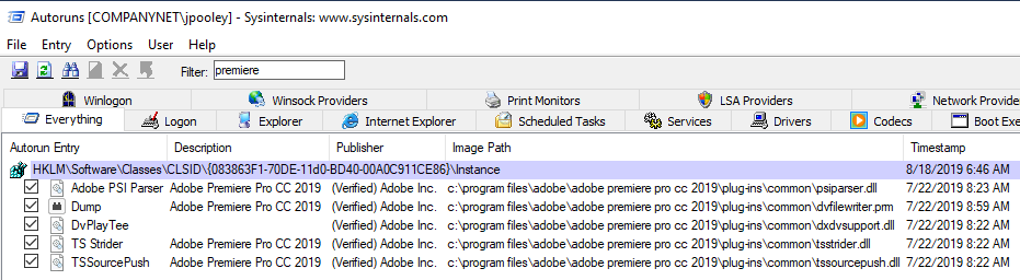

You might have some references to PP 12 still around in the registry.
I have a database software I run, and at some point it was opening a linked file in version 8 rather than 9 and I had a hard time finding the reason. Later I learned it was the install order. With that in mind I've tried to avoid installing v8 on future machines.
EDIT: I believe when I had the problem is when I installed v8 after v9. So, I had clean installed win, and then installed all my main software. Then I need v8 at some point and it stepped on the v9 install and grabbed the various autoruns.
Here's the programs that have helped me the most:

MyerPj​ thanks for reminding me about this tool, I see the same thing on systems that work and systems that don't work.
After running the CC cleaner in full mode and then reinstalling, I am able to get it working on my desktop. I guess this is what I'll have to do for the others, not sure what other root cause analysis we can do.
