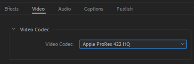

The codec does not appear in Premiere or Media Encoder. Only in After Effect.

Community Beginner ,
Oct 15, 2021 Oct 15, 2021
media encoder/premiere

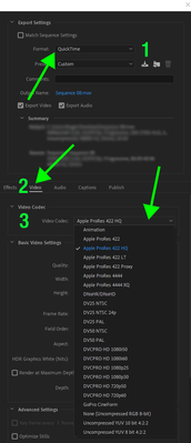

By @xndolv
You don´t have the GoPro CineForm codec either and i see now that you wrote "I'm using a MacBook Pro (13-inch, M1, 2020) and Adobe (2020).". If you are using a M1 processor i would definitely use the latest version of Premiere Pro (15.4.1) and not the 2020 version.
When you install the latest version of Premiere Pro, a re-install of the codec may be necessary.
