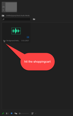

Hi Good everyone I am trying to export media with adobe premiere pro 2021 but I keep on getting this error
Can someone assist me?

You have 3 choices.
Use low quality audio for preview, review and approval. (not for publication)
Buy the audio file
or
Delete from timeline.

Jun 16, 2021 Jun 16, 2021
Yes, you paid for the software, but the audio stock does not come with the subscription that is entirely separate.

How I get about getting the license for this program

You pay for the use of the programs with your CC license, but the use of stock files is a separate licensing fee. For using Stock files, if there's a fee for them, you must pay that to license the use. The same with any other Stock library out there. Now, some of the Adobe Stock files are available for free, and you can sort for that.
But if there's a fee listed, that must be paid to license the use.

I don't see any fees attached to it can you tell me where can I get the license if possible
