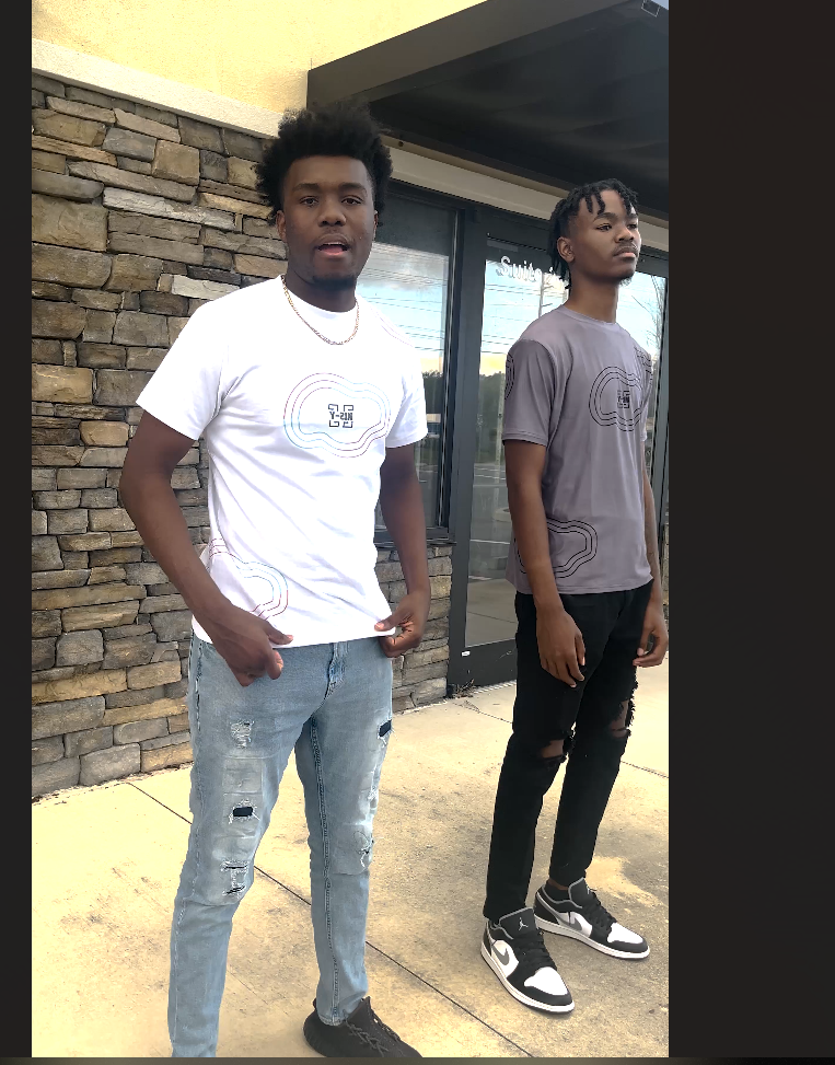

Hello, I'm having an issue where the video I've edited doesn't look the same when exported compared to how it looked in the editor. Drastic difference too.

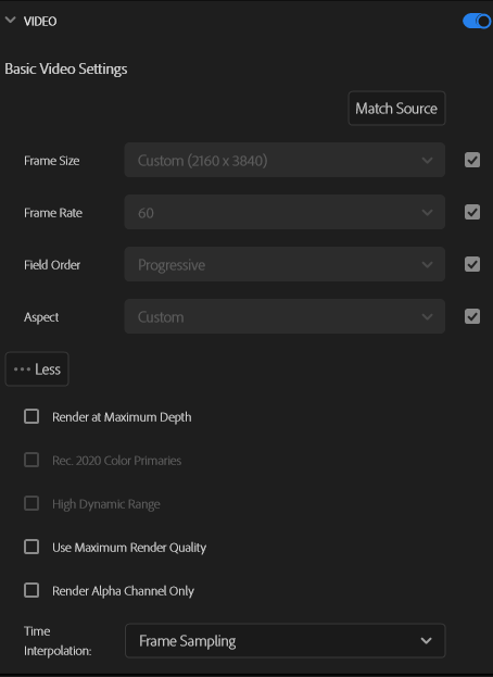

Ill attach some photos showing the difference, the export settings used as well (I've tried multiple variations but only attached my default)
The video was shot with an iPhone, I've worked on previous iPhone videos before without this problem. (Yes, I've tried exporting in QuickTime).
I've also looked at the exported video on multiple devices and it appears the same so I'm pretty sure it's not an issue with the device color coding/settings I'm viewing it on either.
I've looked this up pretty extensively with no luck so if someone here could help me it would be greatly appreciated. I have a client waiting on this video. Thank you.Screenshot 2023-04-03 204736.pngScreenshot 2023-04-03 204800.pngScreenshot 2023-04-03 205136.pngScreenshot 2023-04-03 205149.pngScreenshot 2023-04-03 205200.png

Color management 101 ... your media, your sequence, and your export all need to be in the same color space. This isn't.
Your iPhone clip is HLG, a form of HDR. And your sequence and export are apparently Rec.709, which is SDR.
So easiest thing is simply to go to the clip or clips in the bin, select one or more, right-click/Modify/Interpret Footage, and at the bottom set the Override-To option to Rec.709.
Then redo any color on the sequence, make sure the sequence CM working space is set to
LEGEND ,
Apr 03, 2023 Apr 03, 2023
Then redo any color on the sequence, make sure the sequence CM working space is set to Rec.709 in the Sequence Settings, and use a standard export prest ... one that doesn't have HLG or PQ in the preset name.
