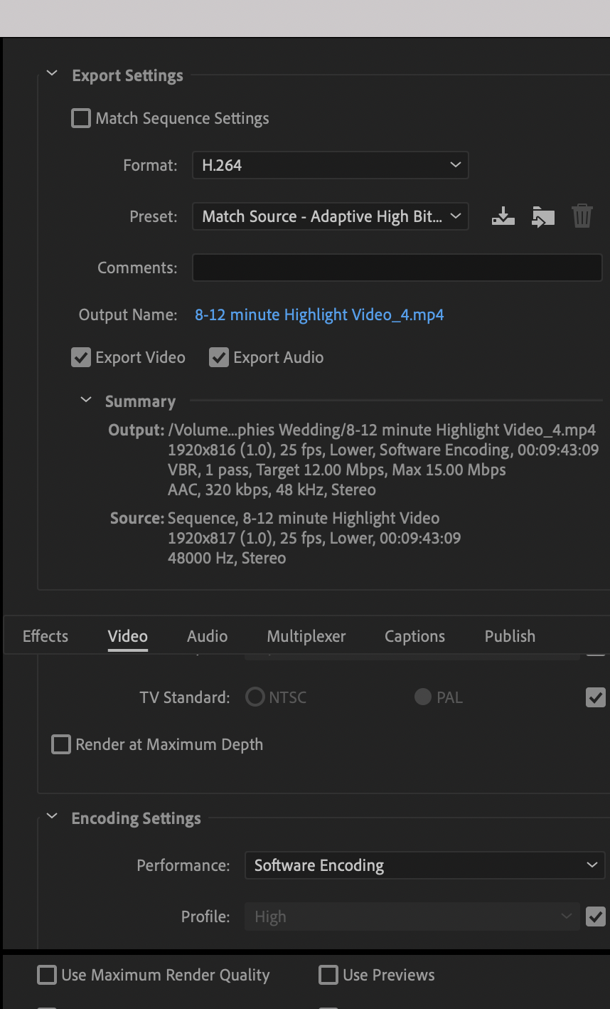

Post screenshot of export settings, sequence settings and clip properties (mediainfo).
Explorer ,
Oct 12, 2021 Oct 12, 2021
I have tried various export settings, from high bitrate, to low bitrate and h.264 to Quicktime, hardware encoding to software encoding and a mix of each. Unfortunately all showing all the same issue. I'll attatch screenshots of each of what you're asking.
