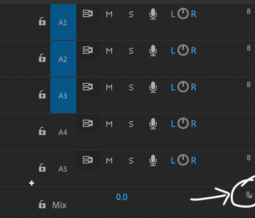

One remaining mystery is when I am on a sequence that was created back then, before I had the need for multichannel export, from what I understand, I can see that some of my sequences already have multichannel settings, like the photo shows

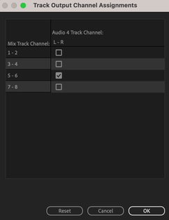

But, when I go in the Audio Track Mixer and Set Output Track Channel Assignment
One Audio track is shown that way,
which the one of the 2 music mono tracks (or I thought it was mono...if it isn't mono, why?)
While all of the other ones are shown that way

From the screen caps you have provided, it is possible to say:
Your sequence is set up with Channel Format set to "multi-channel"; currently you have "number of channels" set to 8.
Tracks A1, A2, A3, and A5 have been set up as "adaptive" in this sequence.
Track A4 has been set up as "standard" in this sequence. In practice this means it's a stereo track (mostly). But standard tracks can accept either stereo clips or mono clips. It treats mono clips as "dual mono" and will simply output the mono audio in both the left and right channels.
In the "Track Output Channel Assignments" dialogs, these two kinds of tracks give you different options - as you have noted.
From your screen caps:
The horizontal list (Labeled "Audio 3 Track Channel" and "Audio 4 Track  Channel") is listing the audio channels that are available on that track (and thus in the clips that are placed on that track).
In the case of track 3 you have 7 channels available, which implies to me that this is a screen shot from a timeline with a different set-up than the 8 channel sequence.
In the case of track 4, you have 2 channels (left and right stereo) available.
When I say these channels are 'available', I mean simply that they must be assigned to mix channels - channels in the "master" or "mix track". This is the vertical list in these screen shots.
The check boxes under the horizontal list correspond to which "master" or "mix" channel they have been assigned to on the vertical list.
Further, you can set-up your hardware (under Settings > Audio Hardware > Output mapping) to assign which "master" or "mix' channels go to which hardware channels.
Finally, in the export dialog, you can activate or select the number of audio channels (from the "master" or "mix" channels) which get exported. This will vary depending on the video codec (only some codecs will allow multiple channels) - and I have less experience and less guidance to give here.
The other piece to all this is that you can modify clips to assign audio channels in the original clips to specific track channels. (But perhaps that is one too many details here.)
I hope that this assists you.
