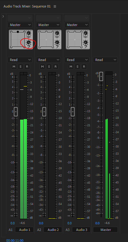

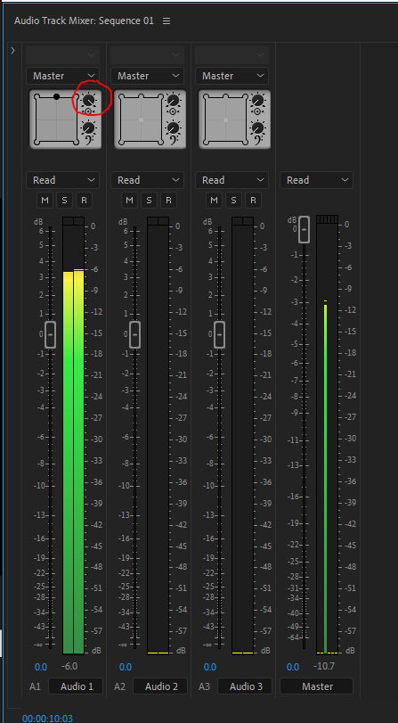

Mar 24, 2019 Mar 24, 2019
If you want to send a stereo track to front left and right only. open up the track mixer and move the puck in the surround panner to centre.
If you want to send the signal to the front speaker, as before put the puck to centre but turn up the centre speaker send.
If you want to send anything to the sub track turn up the sub feed/
