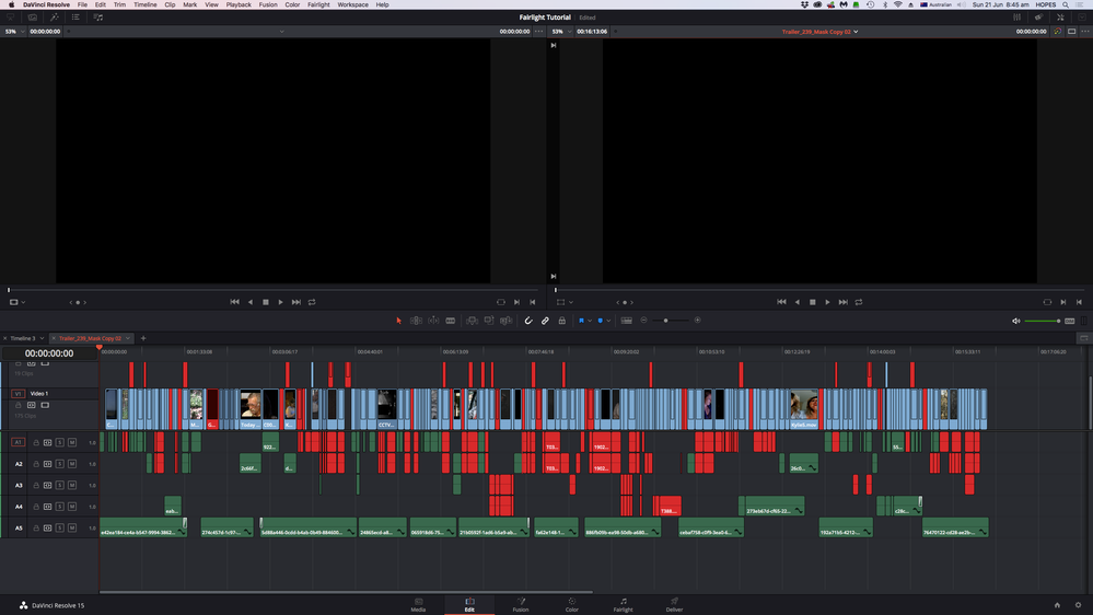

I've just spent two days trying to get an AAF from prem pro into resolve....tearing my hair out now! And I'm pretty good at solving these things... the red clips are NOT linked and when right clicked have no option to link to any file

Hi neil,
Thanks for getting back to me. Yes you're right I should have taken the time to be more concise with my issue. Firstly I also have been delivering TV shows, long form theatrical documentaries to HBO BBC ABC here in Australia for many years with very little bother, typically for color I export a hires master (flattened to V1) with an EDL for the colorist to conform the timeline in Baselight or DaVinci which has worked every time and still does. The last few projects have been slightly different in that instead of OMF2 for audio we have been sending AAF's and again very little or no problems.
With this current project we have moved to 4K UHD aquisition due to a possible sale to Netflix where previously everything has either been SD or HD. Utilizing PP's proxy workflow for editing which has been brilliant. The proxies folder is next to the originals as per the PP default location for these.
We're using PP 14.3 which is the latest version and Resolve Studio 15.3... My best guess is that when exporting an XML or AAF from PP for an offsite DAW the pathways/directories are causing some linkage issues in the destination systems (this is definitely the case with Fairlight) OMF is no longer supported in Resolve so the only way around this for me has been to export audio stems from PP as stereo groups of VX, MX and SFX to be unpacked converted to mono and conformed in Fairlight... this is VERY time consuming however this is all that will work. I will attach some pics and once again maybe it is me but I'm not convinced it is.

Steve HopesScreen Shot 2020-06-21 at 8.45.36 am.pngScreen Shot 2020-06-21 at 8.44.10 am.pngScreen Shot 2020-06-21 at 8.41.11 am.pngScreen Shot 2020-06-21 at 8.34.56 am.pngScreen Shot 2020-06-21 at 8.35.31 am.pngScreen Shot 2020-06-21 at 8.33.09 am.png

the AAF results are varied depending on weather I select 'separate or embed' in the PP AAF export dialog but mostly still not linking properly in resolve... frustrating thing is that the offline media in Fairlight is there which suggests to me that this is leaning more towards the Resolve end having an issue... right clicking does nothing to help me link these files in resolve... our favorite post facility has gone DaVinci exclusive and while I can get a working method to get the color grade to them the AAF audio side is largely still problematic - I have a few weeks to sort it out so I will keep plugging away here testing until I get an answer....
any other input would be greatly appreciated... I am getting our offline suite upgraded this week so I can install Resolve 16 which may help.

Just upgraded from high sierra to mojave... installed Resolve 16.3 and voila!!! AAF import is now A-OK ....actually amazing!! Thank you for all your replies Neil... very much appreciated
cheers Steve
