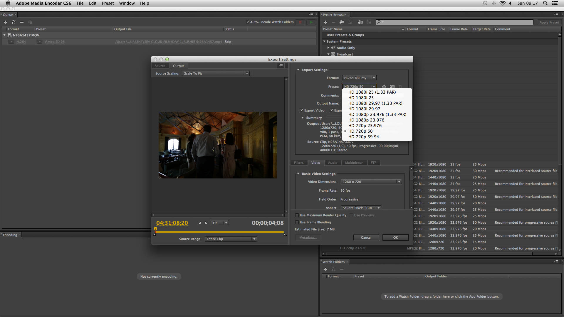

I need to export 2x 55min films onto a bluray, but I've never done this before and am full of questions. Please have a look at the attached image, these are the codecs that I can choose from on my Premiere pro CS6 and Media encoder.
My sequence is in 25fps, and I would usually export it in something like HD 720p 25. But there is no such codec under Blueray in H264.
Do I need to download a codec somewhere? Or can I use one of these codecs without affecting my frame rate?

Feb 11, 2017 Feb 11, 2017
Those are presets, not codecs.
You can customize any of those presets (or create your own), and set the parameters as you require.
In Media Encoder, click on the highlighted preset name in the Queue to open up its configuration window (the Export Settings dialog).

Hi Eikonoklastes, thanks for your reply.
There is no 720p 25 in the lists of preset when I click where you mention. And there is no option for me to set it myself (apart from selecting from a list of presets- as mentioned- I'm not sure will be good for my project's frame rate of 25.) Check out the grab screen down below.
Do I need to go somewhere to download this preset?
Arg, and I need to export all of this by tomorrow morning...

I should confess that I have no experience exporting to Blu-ray. Upon looking it up, it seems that there is no defined Blu-ray standard that allows 720p at 25 fps.
As such, I'm not sure what your solution is, and will allow someone else with more knowledge in this matter to respond. You would ideally want to export to something that matches the frame rate of your source sequence, so perhaps 1080i at 25 fps might be the way to go (but please don't hold me to that).
Good luck.

But, i don´t get what frame size you are working with. One screenshot says 1280x720 while another says 1920x1080. 720p25 won´t work if going to Blu-ray. Exporting 720p25 to 720p50 will works without issues.

You mean this screenshot?
Isn't it indicating 720p because I selected HD720p from the dropdown export menu on top? I shot on 5d mark 3 so it should definitely be 1080.

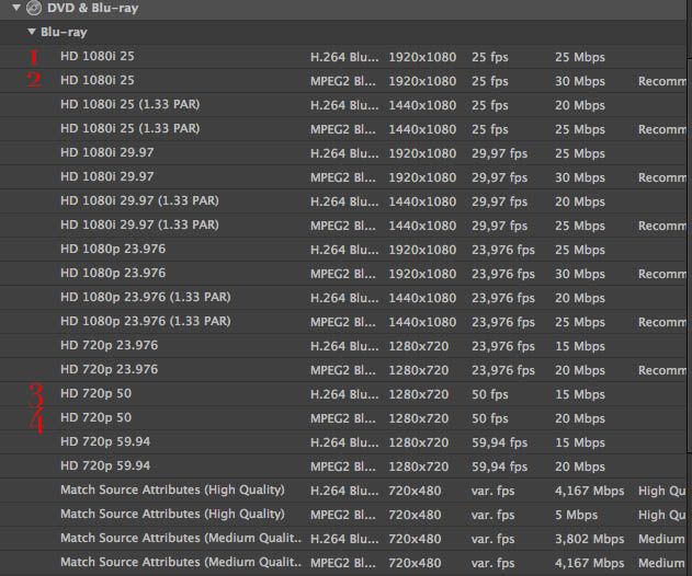

Um, and now between which of these 1080 i (1, 2 ?)and 720i (3,4) should I choose from?
(720 i is in case the 1080 i is way too big for a 25 or 50gb bluray)

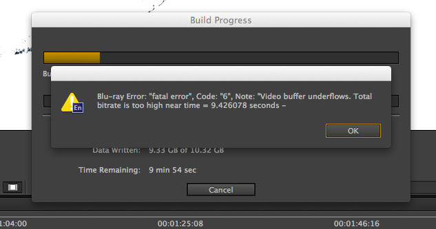

Hi everyone,
Thank you kindly for all of your help so far. Thought everything was good to go, got my Bluray prepared in Encore Cs6, etc, generated the folder and then bam, got this error message:
Thanks to which I have missed my deadline AND am currently paying an agency to try to fix it for me. But for you guys who've been following my "story" since the beginning, do you have any ideas from where that might be coming from? Doesn't seem to be any clear solution anywhere online. I need to finish this very very soon, like yesterday, litterally. Arg!
Thank you so much in advance!
Feb 13, 2017 Feb 13, 2017
Export again from Premiere
Make new project in Encore
Import the two files (audio and video)
make iso (image) and burn to disk with e.g. Imgburn
On a side note: practice with the software first before taking on a job with a deadline.
Premiere and Encore have a steep learning curve, and things dont always go smoothly the first time.

Tried various things (exporting in VR 2 pass and lowering bitrate to 20mbs and exporting in 1080p 25)
No luck, same error.
Help?
Feb 14, 2017 Feb 14, 2017
The only thing I can think of to get the project out of the door is to export to mpeg2 Blu-ray (same settings)
btw 1080p25 is bd illegal.
Explorer ,
But two different "experts" (editing lecturer and BR burning agency) told me that "it was weird that I should export in 1080p25"
Isn't mpeg2 BR going to be really bad quality? One of those same experts told me exporting in Mpeg2 was going to give me DVD quality.
So according to the below grab screen, I should export in 2?
Do I stick to VR 1 pass or do I put it again to VR 2 pass, or CBR?
No one here told you to export in 1080p25. As said before its bd illegal.
I dont have a solution to your error.
If you cannot get H.264 to work you have no choice but to export to mpeg2.
But you are more then welcome to use other software
2 and stick to the default settings.
It wont be dvd quality, It will slightly less then H.264.
