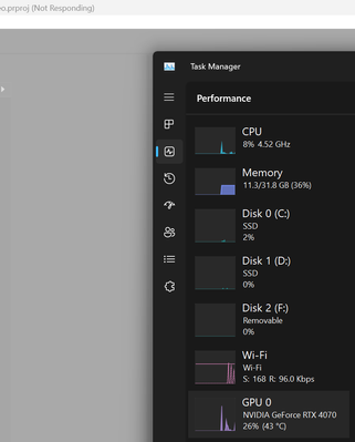

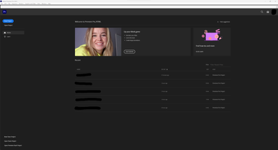

This is the first time I'm using Premiere Pro in a while, and I've installed the latest version (24.1). However, I'm experiencing frequent crashes in the program, and the timing seems somewhat random. For example, sometimes the program crashes immediately after I open a project, while other times I can work on the project for 10 to 20 minutes before it suddenly crashes (usually it just crashes but sometimes it freezes for a while then crash). There are instances where I can render without any issues, but other times it crashes during the rendering process . Nevertheless, the crashes only occur when I open a project, not when I open the program itself, i.e. it is fine in this window:

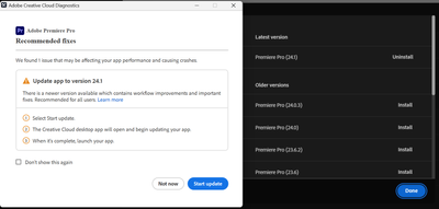

The Adobe Creative Cloud Diagnostics pops up after the crash (although not always), and I've used it for assistance, but it only suggests upgrading to the newest version, which I have already got...

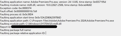

By using Event Viewer>Windows Logs>Application, I found out that the problem is ntdll.dll.

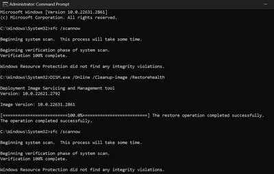

After that I followed the guide linked here to check and repair any corrupted file:
In fact, I scan the ntdll.dll in particular after the procedure and it says that the file looks fine:
But Premiere Pro STILL CRASHES, and the problem, again, is the ntdll.dll (checked with Event Viewer).
Can someone please tell me how can a perfectly fine file causes crashes... I don't really want to reinstall Windows because it is NOT my personal computer (FYI I'm working in a small company which don't have an IT department and the computer that I'm using is the comapany's).

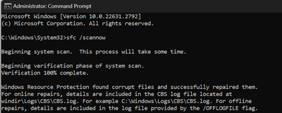

PS. Before I ran the whole process, I ran "sfc /scannow" and it gives:
of which I belived that it repairs some corrupted files.

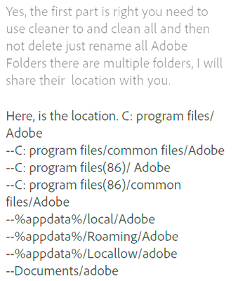

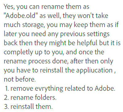

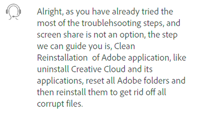

Update on 2024/1/15:
It's been a while and my work doesn't require me to use Premiere Pro (and I was travelling 🙂 ) so I haven't been updating. I did the following in late Dec 2023.
  1. Used the cleaner tool, plus manually renaming files to completely remove Adobe from my computer (as instructed by the Adobe person). Re-installed them, but Premiere Pro still crashes. Details at the end.
  2. Used an alternative Adobe account to launch Premiere Pro on the same Windows account, there were no signs of crashing.
  3. Used an alternative Windows account, but with the original Adobe account to launch Premiere Pro (as told by the Adobe person), there were no signs of crashing.
So in the end, we think Adobe is not the one that causes the problem, Windows is.
Details of (1):
