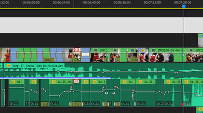

Participant ,
Oct 30, 2018 Oct 30, 2018
Thanks for your help. Please let me know if you need any other information to resolve this Audio Waveform issue:

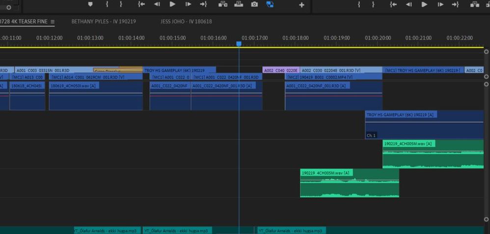

Would you like me to start a new post on UserVoice or copy/paste the links of all the posts I just upvoted? A quick search of "waveform" over there turned up at least 6 on the first page that touch on this issue from one angle or another, going back to 2018.
This is what I'm facing:
Pre-Cache Wipe:
Post-Cache WipePost-Cache Wipe
Post-Cache Wipe
Pre-Cache WipePre-Cache Wipe
And sometimes, if I'm really lucky, a thin red line appears with no explanation.
And sometimes, if I'm really lucky, a thin red line appears with no explanation.And sometimes, if I'm really lucky, a thin red line appears with no explanation.
