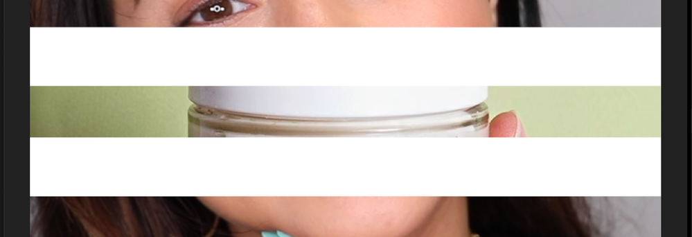

So With-in premiere everything looks perfect. I'm dynamic linking to after effects in order to accomplish a certain transition with graphics and roto (there's no motion blur activated anywhere).
There is infact a file i'm using with-in the project which was 30fps which I re-interpretted the footage to 25fps; also polsterized the time to 25....
And i know my render setting are fine, just started H.264 (never had an issue)
Perfect solid white line In premiere:
Ghosting effect after export:
3.0K
Community Expert , Sep 18, 2019 Sep 18, 2019
Set everything (sequence settings and export settings) to No Fields/Progressive and try again.

Hey, I've change the file which was 30fps to 25fps. As in re-rendered it to 25fps then re implemented it in. See the image you requested below
Your settings are set to lower field. Are you using interlaced material if so set it to upper. If not set it to No fields.

No, How could i double check though. Also Just rendered out of after effects one of the panels/dynamic links and it was absolutely fine??
LEGEND ,
What Ann said - and not just the Export, but the Sequence Settings also should have Fields set to None/Progressive. The lines in your latest pic example are interlacing that you don't want (from Lower Field First setting).
Community Beginner ,
Sep 19, 2019 Sep 19, 2019
I can't believe it was that simple, that worked - thank you Ann!!
