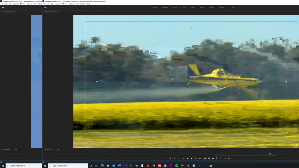

Does anyone have a solution for this problem?
I've been having problems in Adobe Premiere where random frames in my sequence appear glitched and broken, and sometimes even render out in that state.
I've attached three pictures of the problem occuring, note how they look suspiciously like a typical "bad frame" on a corrupt H264 video. While my source footage is AVCHD format (and therefore actually H264 under the hood), I can confirm they aren't the result of corrupt files or an actual part of the footage - these glitched frames appear at different points in the sequence each time I open Premiere, do not appear in other programs and sometimes "fix themselves" after a while.
I have confirmed that turning off GPU Acceleration fixes the issue, but for a couple of reasons I would prefer to find a better solution that this. I can also confirm that the GPU Hardware itself is not at fault, as I tried other GPUs and the problem remained.
I am using the latest version of Premiere Pro (14.7) and the latest NVIDIA Studio Graphics driver (460.89).

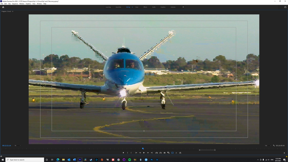

Okay, I downloaded you file and found somethign very interesting.....
The file is perfect by the way, not a single frame is damaged.
Premier and media player will play it perfect at the native frame rate, also plays fine at 200%, 300% and 400% when using frame sampling (The default).  I had to do no rendering, despite the timeline being red and in same cases yellow is played fine;
If I changed the blend mode to Optical Flow;  it starts to look like the sample you provided.  I will attempt to attach the screen shot.  Once I changed it to Optical flow;  the playback issues started to show up.  I could change it to frame blend or frame sample, and the issues were still present.  If I scrubbed the timeline the issue would appear on different parts of the video, not always the same
I decided to render preview the timeline, and then when scrubbing all those artifcats were no longer present.  It didnt matter how hard I tried, scrubbing didnt reveal the artificats pictures below.
I will also say, that its 100% repeatable,  I can very seldom scub without issue.  Playback was always fine for me after I rendered the preview files without fail.
This is the timeline after I enabled optical flow, and started to scub it agressive.  The quicker the movement of the playhead, the easier it was to get this result.
I then decided to use Media encoder to drag the file you provided into it, and used the YouTube Present and converted it to a MP4 container.  The file performs flawless on all scubbing and I could not duplicate the issue at all that I captured above.  The MP4 container takes a marginal split second that you can notice to render the frame the frame you stop at when scrubbing.  But in 100% of the testing, there was never any artificating.
I am can say that 100% of every single frame of video you provided is fine.  There is somethign wrogn with the encoding or decoding of the .MOV container you were using.  I lean towards the decoder in premier for the timeline itself, as media encoder had no issue using the NVENC encoder to convert it to a MP4 file, and it scubbs and plays back perfect at 100%, 200%, 300% and 400% with agressive time line scrubbing.

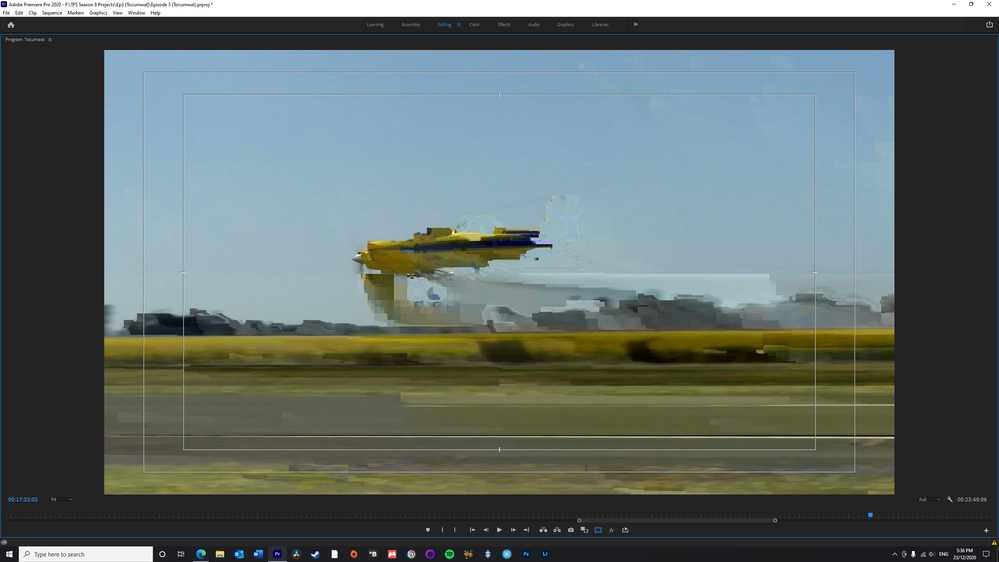

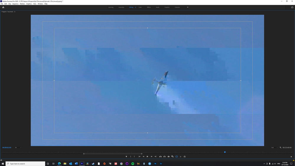

Here are the images from when i first encountered this problem:
And this image is from when the same error occured with Mercury Playback Engine set to Software Only:
Also, quick update: i noticed only yesterday that Nvidia released a graphics driver update (461.09), albeit via the "Game Ready" channel rather than the "Studio" Channel. I tried switching to that channel to get the update but alas, the error remains. Here's a screenshot from after that update:

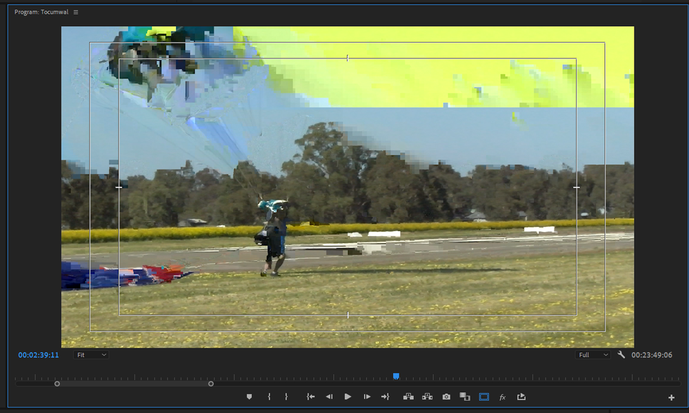

UPDATE: To my horror, the error has now appeared in another project with GPU Acceleration turned off!
Again, I have confirmed it isn't the video at fault. I moved to the next frame and back and the glitch vanished immediately.
I am using a feature on my motherboard called MSI Game Boost, which I gather is essentially a sizeable CPU overclock. There is a *chance* that it's pushing my CPU a little too hard and making my system unstable, but I'll look into it. Stress testing with a program called OCCT threw up one stability-related error, but the same test later showed no errors. I *think* the original error with GPU Acceleration turned on still occured with Game Boost turned off. As established earlier, downclocking my RAM/turning off XMP has no effect.
Here's an image of the glitch reappearing without GPU Acceleration:

Apologies, here are those same images embedded:
