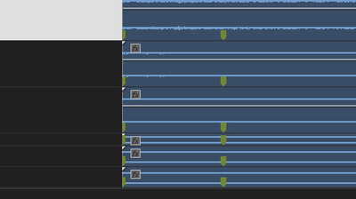

Hello, I am not sure what I pressed but now these green markers have appeared inside my clip and I was wondering 1) how to remove them and 2) what are they for?

You hit the M key while the clip was selected. Which created a Marker. If ... without moving the playhead ... you'd hit the M key a second time, the Marker's dialog box would have popped up, where you can name them or make a note in the description area. Set a color, so you can have markers for various purposes or people.
A marker is a ... mark. To tell you or someone else something. A way to store notes.
You can use commands to go to the next or previous marker, or you can open the Markers
You can use commands to go to the next or previous marker, or you can open the Markers panel, and even navigate to places on the timeline by selecting a marker. You can read the notes for that marker.
And of course there are commands to delete markers also.
Using the Help menu, get to the Manual and check the section on markers. Very useful tools.

ahh thank you, I didn't realize you could marker individual clips as well. I kept clicking away from the clip and hitting the clear all markers shortcut and was confused on why they didn't dissapear.

Neil, when there are Markers on the clip itself, it is impossible to remove it specifically from one clip and not from all. Or am I wrong? Only with the command from the Markers tab - delete all Markers. I am interested in the question: how to delete a Marker marked on a particular clip? There is no usual click and delete function, as is done with Markers that we place on the timeline.

In the Marker's Panel, you can select one marker, hit delete, it's gone. Hold down Ctrl/Cmd while clicking several markers, hit delete, they're all gone.
You should probably learn a little bit about Marker keyboard shortcuts, which I've been using a lot. You can navigate using the "next marker" keyboard short to a marker and delete it, for instance.
And of course, there's the all-purpose "remove all markers" keyboard shortcut. If you go to the Keyboard Shortcuts dialog (Ctrl/Cmd-Alt-K) and type 'marker', there's probably at least 30 different actions with markers that either already have a keyboard shortcut or can if you choose to set it.
