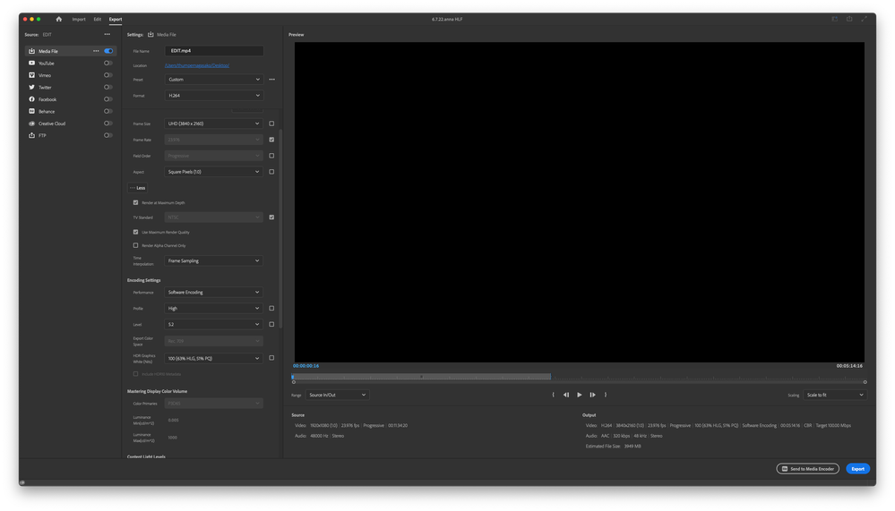

This has been my typical export you can't see it but it's CBR 100Mbs below.
LEGEND ,
Jun 14, 2022 Jun 14, 2022
I noted you have a 1920x1080 sequence, but are exporting UHD ... 3840x2160. That of course can be problematic ... are all the clips involved UHD, or are some/all 1920x1080?
Explorer ,
That's just because my video previews are set to 1920x1080.  The project is 3840x2160 see sequence settings. Screen Shot 2022-06-14 at 1.18.36 PM.png
