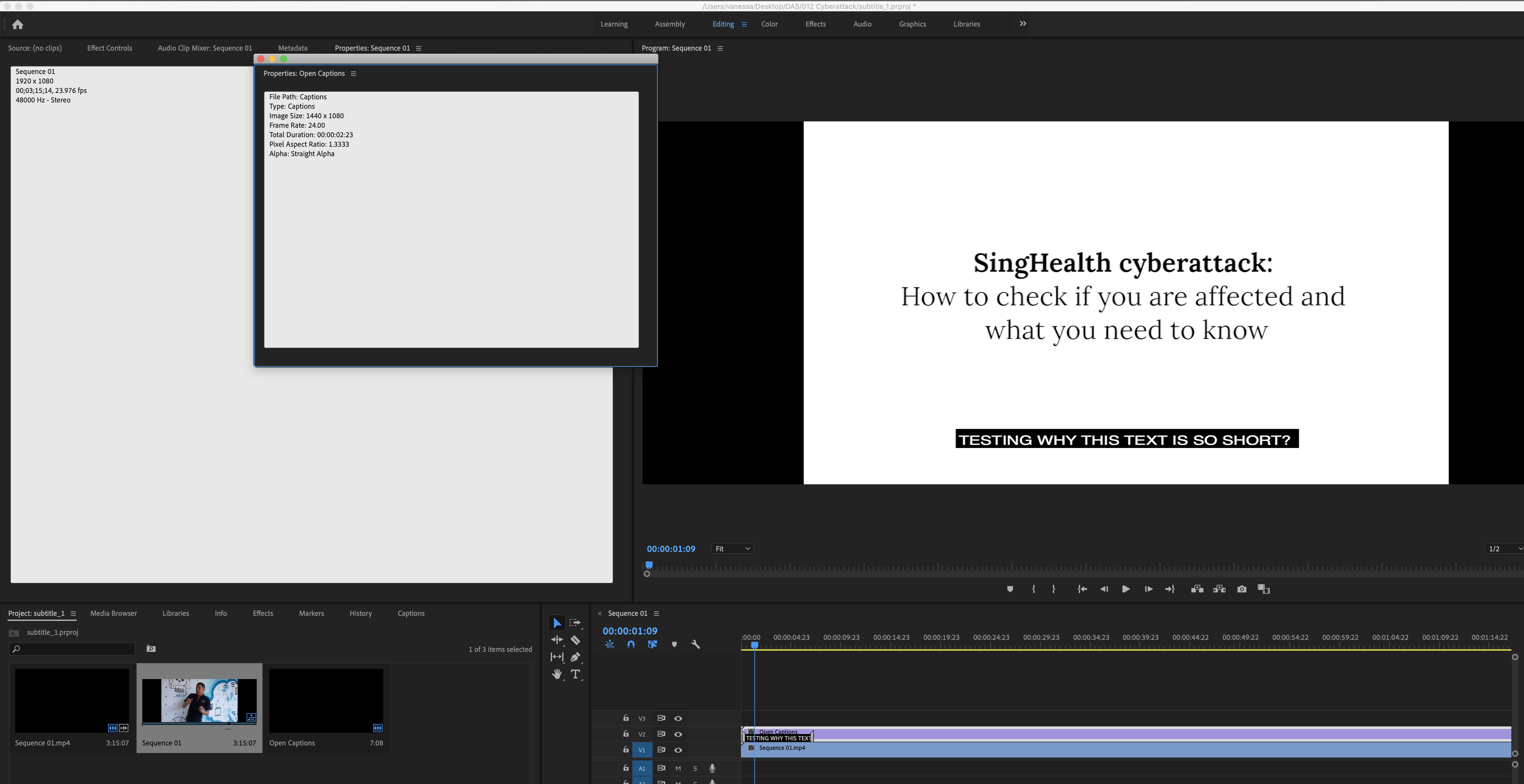

I've attached the screenshot and you could see the caption... I had export the video and open in the new project but it is still the same... TT__TT

Community Beginner ,
Oct 31, 2018 Oct 31, 2018
I had followed Anna's suggestion but it is still the same??

Enthusiast ,
The X/Y values are not the size or scale of your font. They are the position of your caption relative to the caption frame.
You are using a non-square pixel aspect ratio in your sequence (1.33), and the captions seem to be unable to adjust to that.
Even when creating a caption with a matching PAR, it shows up distorted in the sequence. This is possibly a bug, and you might have to work around this by copying and pasting your captions into a square PAR sequence and export them from there.

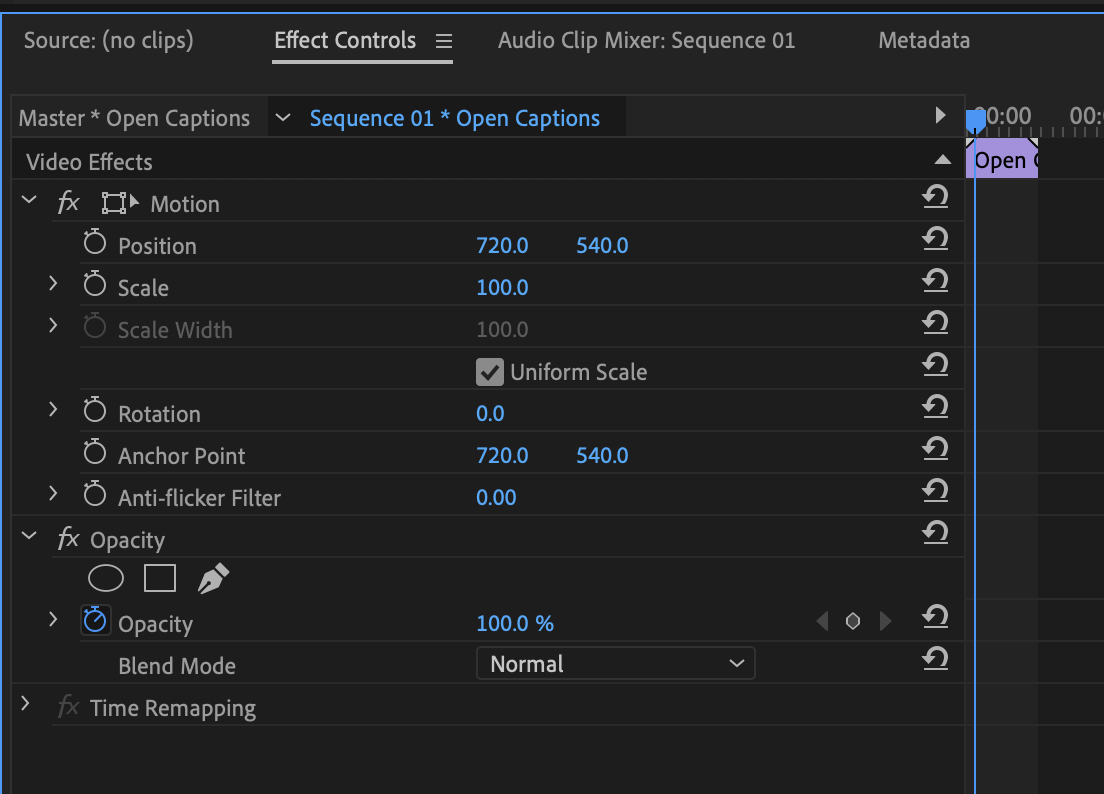

Could you post a screenshot of your effect controls panel for the caption stream on this timeline?
this is the effect control..
i had checked my video file size, it is 1440x1080 and also caption size is 1440x1080...
i need to change video size to 1980 then the subtitle will be fine?

I think you mean 1920. That's a good question: Ann, are you saying the 1440x1080 1.33 can just be edited in a 1920x1080 sequence? It looks okay to me, but I never did work with anamorphic much.
Hiroko, you must be working with a caption stream that is 1920x1080 square pixels. No matter how I try it, if the caption stream is 1.33, it is stretched horizontally. I think this is a bug. It looks okay if I place it in a 1920x1080 sequence and then nest that. Ann's method will be simpler, because the captions will be editable in your main sequence.

I just tested it with 1.33 footage
If the sequence and captions are 1.33 you get squished text.
If you change the sequence to 1920x1080 par 1.0 and modify the captions to 1920x1080 par 1.0 the text looks normal.
