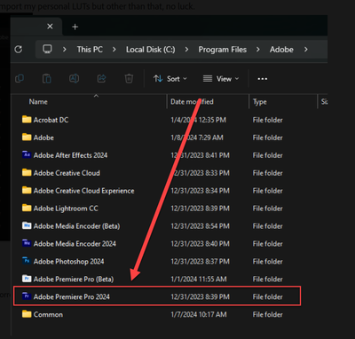

I believe my downloads and files are all out of whack, as seen on the screenshot I dont even have a folder for Premiere Pro! The Common folder down below is where I was able to import my personal LUTs but other than that, no luck.

Wherever you told your computer to "park" the Premiere Pro program files, that's where that folder will be.

A folder that happens to have a PrPro icon..................
Copy link to clipboard
Copied
Wow I am so embarrassed, I thought that was just the actual application.... My apologies for the long thread of time wasting
