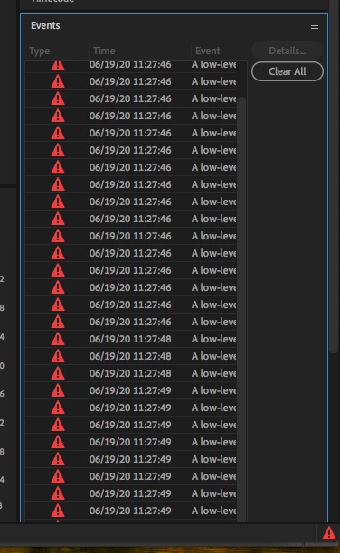

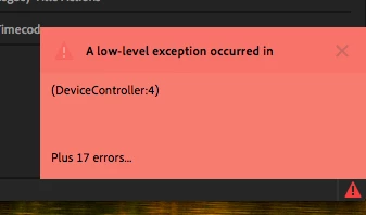

Last night I upgraded the Premiere for the last version and this message started to happen when I tried to edit a video.
"A low level exception occurred in: DeviceController:4"
The screeshoot below shows the error
Now I can't add titles or do many things.

Correct answer Mitch W
The issue only occurs in 10.13.6 and happens anytime the preferences are touched. It's irratating, but otherwise harmless. Update the Mac OS to resolve.

I was having the same issue. But this is what I did and looks like it worked!
Go to > Premiere Pro > Preferences > Device Control > Devices > None
Then press OK

This worked for me a few weeks ago on a late 2013 iMac, running OSX 10.13.6 and Premiere 14.3 (I forget the build number; have updated since).
Go to PREFERENCES > DEVICE CONTROL > then select NONE from the dropdown and click OK. Save your project again and re-open it.
The error messages went away, however when I go back now on 14.3.2, it has reselected the option $$$/MediaCore/DeviceControl/DeviceControlFirewire/DVHDV_DeviceControl=DV/HDV Device Control. But again, I have updated Pr to 14.3.2 (Build 42) since and haven't seen this error yet.
