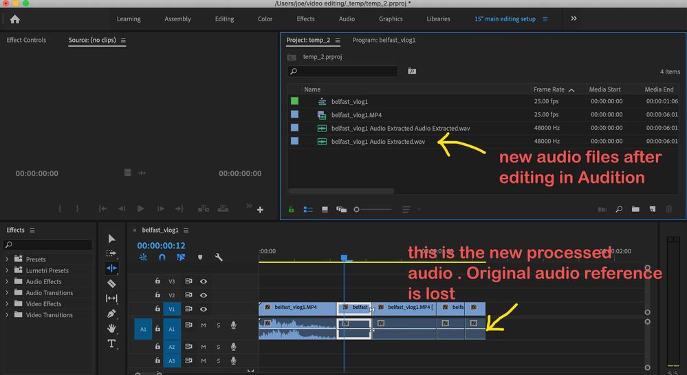

I'm not sure we're talking about the same problem, let me clarify what I mean. When you create a dynamic link and then edit in Audition it creates a new wav audio file which it then associates with the video clip to the timeline, losing the original reference to the audio kept with the physical file (as I understand it).
What I am actually asking I guess is, how do I remove all my references to processed audio files and return the clips to the original reference of the sound when it was imported to Premiere. The problem I have is that I have several sequences whose audio is over-processed and over 1000 edit points. I need to basically reset the audio reference/link to the processed audio and keep the audio of the video file without having to go through each clip and linking the audio again!
Below is a visual reference of what I mean. Maybe someone can enlighten me how I can reset the reference to the original audio (that sits in the video file)?

Jan 29, 2020 Jan 29, 2020
Right click on the clip in the timeline and hit 'Restore unrendered'.
You should be able to multi-select all your clips and do this in one go.

Brilliant, that's what was looking for!
