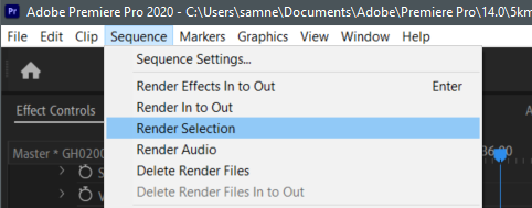

If you have one or more clips selected in the Timeline, you should be able to choose Sequence > Render Selection from the Sequence pull down menu.
As you'll probably use this often, you can set a custom keyboard shortcut in the Keyboard Shortcuts dialog box (Edit > Keyboard Shortcuts, Windows or Adobe Premiere Pro > Keyboard Shortcuts, Mac).  In the Keyboard Shortcuts dialog box, enter "Render Selection" in the search text field and that should filter the list to Application > Sequence > Render Selection.  You can click in the Shortcut column to add a shortcut.  If you haven't set any other Keyboard Shortcuts, "Shift Enter" should be available.

UPDATE for 2020: Select your clip > sequence menu item > Render Selection
