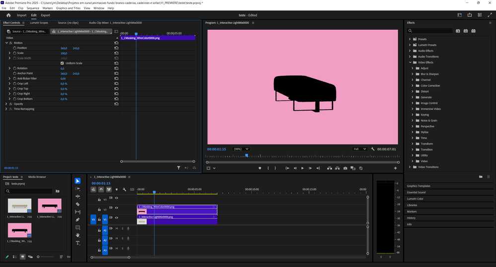

Hi there!
I rendered an animation in 3ds Max + Corona and, besides the LightMix render, I also ended up with the CMasking_WireColor. My plan is to whiten the background in Premiere, while maintaining a soft shadow. Unfortunately, using the Corona Shadow Catcher Material didn't give me the results I wanted.
Does anybody knows how to select the background color in the CMasking_WireColor video, in order to select the Interactive_LightMix background video (the main one, with the textures) and lighten it up (similar to what is possible in Photoshop)?

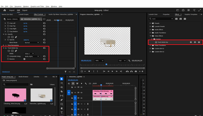

Welcome to the Premiere Pro community. If I understand your question correctly, you want to use CMasking_WireColor to remove the background from Interactive_LightMix. To do so,
1. Apply the Luma Key effect on CMasking_WireColor and set the Cutoff to 50%.
2. Apply Track Matte Key on Interactive_LightMix. Set the Matte to Video 2 and enable Reverse.
(To enable the transparency grid, select the wrench button on the Program panel and select "Transparency Grid")
In case I misunderstood your question, could you please share more details?

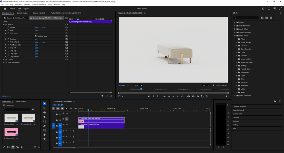

Adobe Employee ,
Aug 14, 2025 Aug 14, 2025
I see. You can do that by following the steps in my initial reply and adding another clip of Interactive_LightMix at the bottom. Then, select the bottom clip and go to the Lumetri Panel to make the color adjustments (top menu bar, Window > Lumetri Color). I have attached a screenshot where I have lightened the background color by increasing the Whites slider in the Lumetri Panel.
