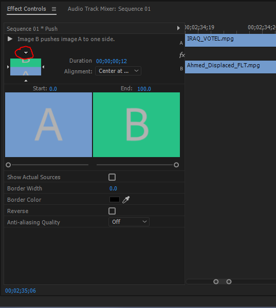

I think the Push effect would work for you, per MTD. You can change the direction of the push to vertical and should be good to go using the little box above the A/B with 4 arrows

You can do this transition left to right or right to left by using the effect Effects > Video Transitions > Slide > Push but I am not sure there is a pre-built effect that will do this move vertically.

"push" effect then choose your side, up or down, left, right
