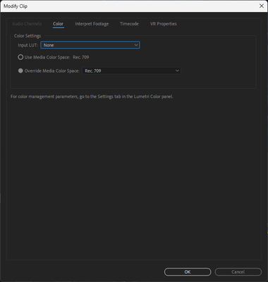

Right click source, click Modify -> Color. Add Input LUT in this screen:
I generate my own LUTs. Do my own color space conversions and tonemapping, incorporating my own grading, rather than just standard color management. I have one LUT for SDR output, and a different LUT for HDR output.
