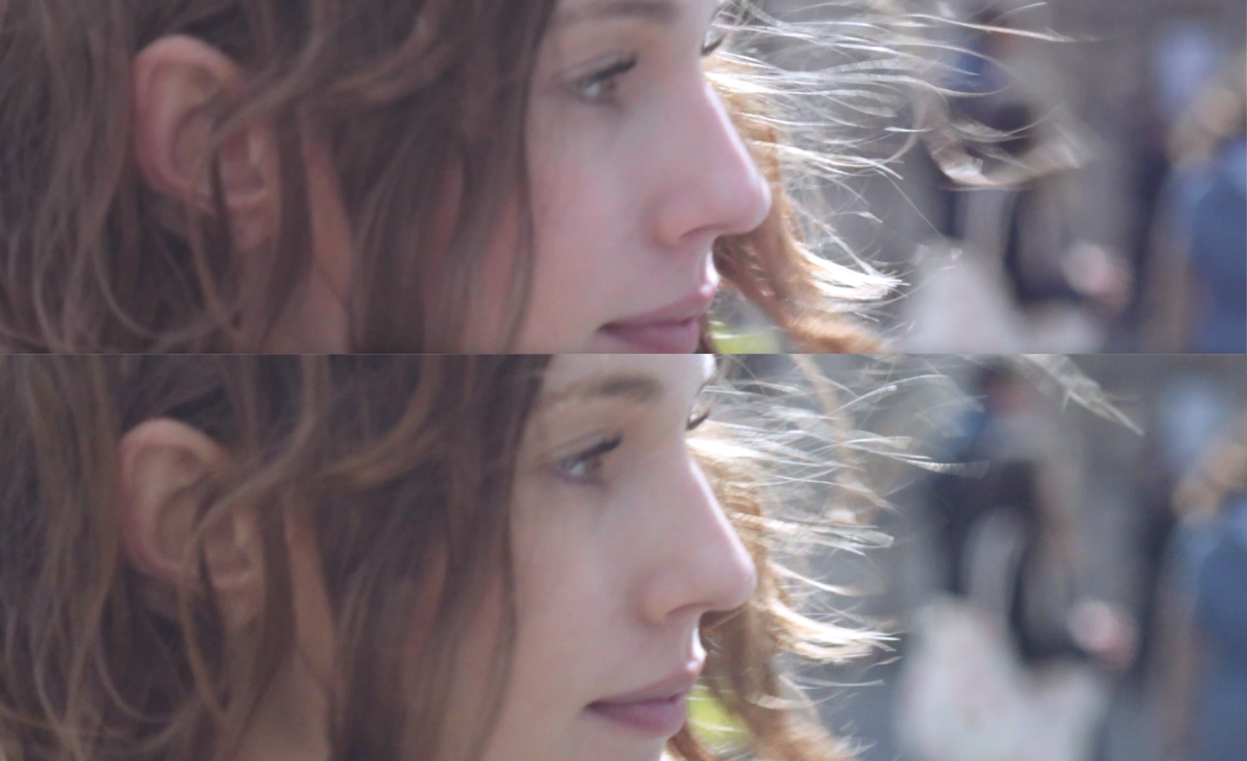

That's not a difference in the screen. I've done several tests, and i may have found an answer.
The issue is still occurring with a calibrated display. But i've noticed two things.
First one is that changing from GPU Mercury Playback Engine (Metal) to the others doesn't change anything to the way pictures appears. By experience i noticed that the files are not displayed the same way when the graphic card is or isn't activated with this setting. It seems that the GPU isn't use properly by Premiere.
The second one is that in Final Cut Pro X, the footage looks way better. In fact i manage to recover the gradings i had on my previous laptop.
I also use the same grading on both softwares with the same plug-in. In Premiere there is these weird red zones, not in FCP X.
I'm a Premiere Pro user and i don't want to switch to Final Cut Pro X, and i'd really want to have a solution for this.

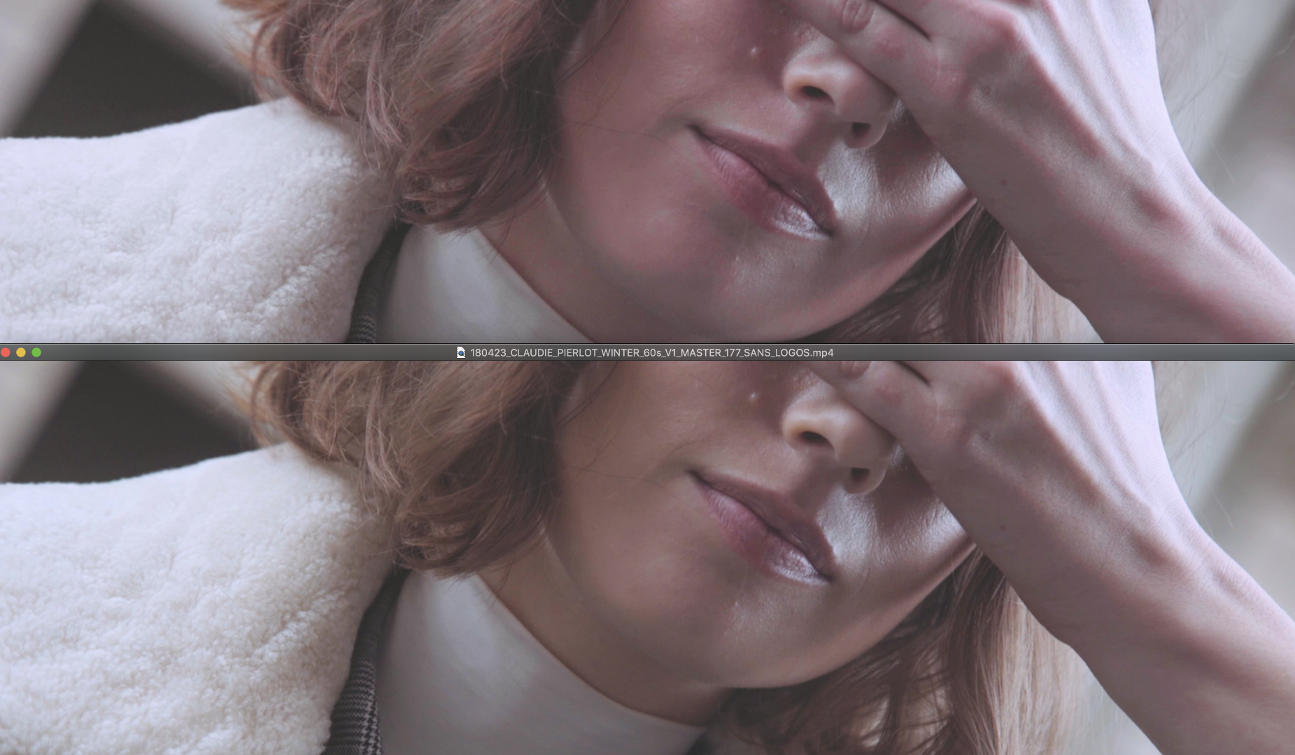

I don't recall if you've posted a screen-grab of that back through this thread ... have you?
Neil
Community Beginner ,
Apr 18, 2019 Apr 18, 2019
I had. But here's a comparison :
Capture d’écran 2019-02-17 à 22.38.11.pngCapture d’écran 2019-02-18 à 01.12.44.png
